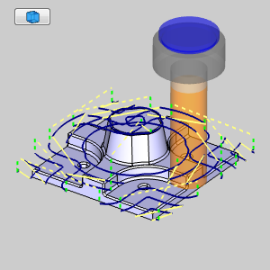

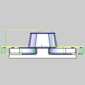

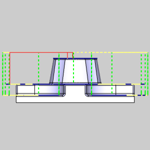

On our example part, we have used a solid model to set the stock to a specific shape. In this case, we have roughed out the stock with an Advanced Rough and have finished that up with a Flatlands toolpath. It is the rapid heights of the Flatlands toolpath we intend to adjust. Take a moment to notice there is only two rapids, highlighted in red in the images below, that need to be at their current height.

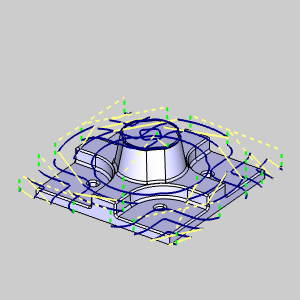

Take a moment to look at the existing stock compared to the existing toolpath
to see what we intend to accomplish.

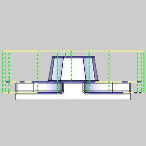

3 Rotate
the part into a side view.
Notice most of these rapid moves could be lower to save some machining
time.

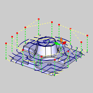

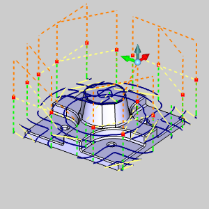

We now, need to select the Point Pick check box under the Selected Toolpath Elements list so that we can pick the points where the vertical and horizontal rapids meet. Once this is selected, we will move the rotate the part, as needed, to pick all sixteen toolpath points shown in the images below.
1 Under the Selected Toolpath
Elements list, select the Point Pick
check box.
This will allow us to pick the point at which two toolpath elements meet,
thereby giving us the ability to adjust both elements, rather than just
one element or the other.
2 In
the graphics area, select the toolpath points shown in the image below.
In each of the four corners of the part, there are two rapids. Be sure
to pick both points on each of the eight rapid moves.

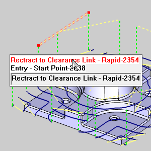

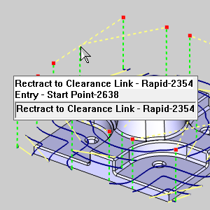

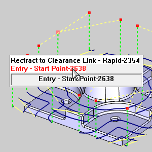

NOTE: When toolpath elements are close enough together, attempting to select one may cause a dialog to appear. This dialog will allow you to select, from the dialog list, the intended toolpath element, as seen in the images below.

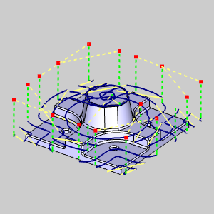

1 In
the Parameters group, select the
Drag option.
The Drag handles appear in the graphics area.
2 Click
the Z Axis of the Drag Handle.
The Z Axis highlights.
3 With
the Z Axis highlighted, move your mouse up and down and notice the preview
adjust.
While the X,Y, and Z values can be adjusted visually, we will enter a value
in the Delta Z text field.
4 In
the Delta Z text field, enter -1.0.
1 Click
Execute.

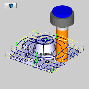

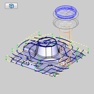

1 Select
the check box for Animation.
2 Use
the Animation controls to play through the animation. With either the
(Solid),
(Transparent),
or
(Wireframe)
view.
