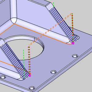

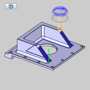

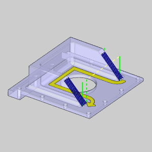

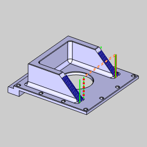

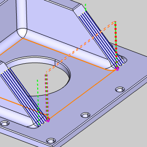

On our example part, we have created an Advanced Planar toolpath, and have used boundaries to isolate it on the angled surfaces of our part. In this case, the toopath has been separated into two separate regions, and those regions are connected with a rapid. It is this rapid we will replace with a feed move that traces around the inner fillet in the direction seen below.

the CAM Tree, click the
Advanced Planar operation of the
Feature 3 Axis
to highlight the toolpath in the graphics area.
Take a moment to look at the existing linking between toolpath regions
to see what we intend to accomplish.

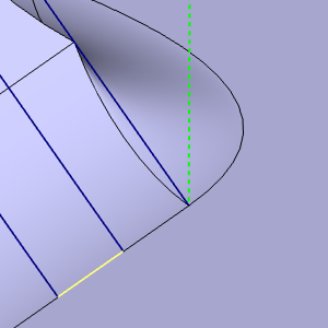

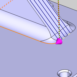

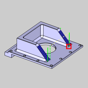

1 In the graphics area, zoom
into the area shown in the image below.

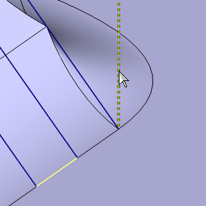

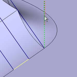

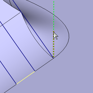

2 Hover
over the lower portion of the retract move and click on the toolpath element
shown below.
Important : If the toolpath elements that highlights is not the first move of the rapid, as in the image below, be sure to include the first toolpath element in your selection as well.

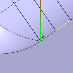

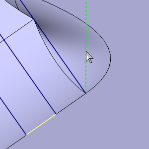

4 Now,
zoom into the area shown in the image below.

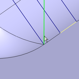

5 Move
your mouse to the end of the green toolpath element.
6 Press and hold Shift and
click the bottom of the
toolpath element to perform a chain selection of all the toolpath elements
between.

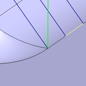

With the toolpath elements selected, we will need to set the Toolpath Chain to define the new path of the toolpath elements.
1 In
the Parameters group, click the
Pick button to begin selecting
the Toolpath Chain.

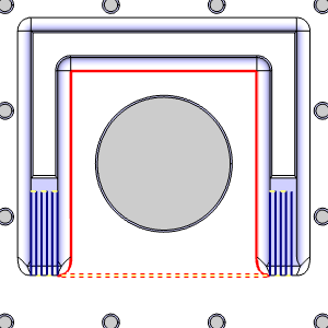

2 Select
the five individual edges on the model, as shown in the images below.

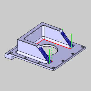

3 With
the five edges selected, right-click and select
OK.

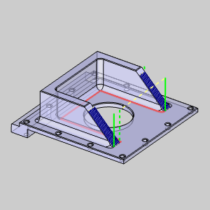

The executable preview displays.
In some cases, depending on the direction of the Toolpath Chain, the preview may show an unintentional result, as shown in the image below. In these cases, we would need to Reverse Direction.
1 In
the Toolpath Chain list, click on Chain
1 to highlight it.
The Chain highlights and shows directional arrows.
2 Right-click
Chain 1 in the Toolpath
Chain list.
3 Select
Reverse Direction.
The chain reverses and the preview updates.

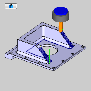

1 Click
Execute.

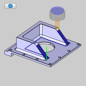

1 Select
the check box for Animation.
2 Use
the Animation controls to play through the animation. With either the
(Solid),
(Transparent),
or
(Wireframe)
view.
