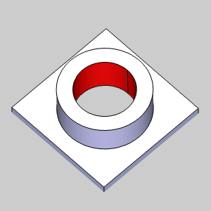

This tutorial explains how to create a multi-start thread using the Thread milling feature and a toolpath pattern. The result is a 2-inch diameter I.D. multi-start thread with two start points.

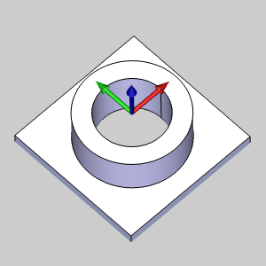

The part geometry for this example is shown next. Stock has been created using the Solid Model option, and the machining origin is placed at the top and center of the stock. Because we are making a 2-inch ID thread, the hole diameter of the part is 1.8125 inches.

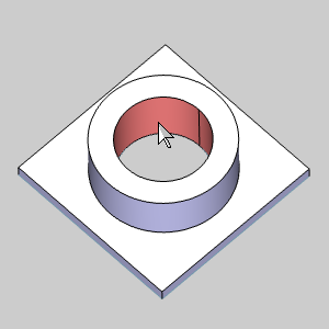

3 Click the inner cylindrical surface of the part model.
To confirm the selection, click

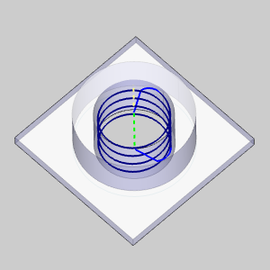

7 Click Next>>, and in the Lead-in group, select Helical.
In the Radius box, type 0.300.
To create the toolpath, click Compute.
The result is shown next (the part is made transparent to make it easier to view the toolpath).

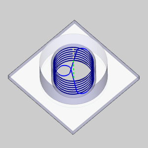

1 In
the
CAM Tree,
right-click
Standard
Feature Mill Hole, and click Add
Toolpath Pattern.
2 In the Toolpath Pattern dialog box, click Rotate, and click Next>>.
3 In the Rotate group, set the Angle to 180, and set the Copies to 1.
4 Because the machining origin is placed at the center of the thread, which is also the center of rotation for the pattern, the Rotation Axis Origin values are X0 Y0.
5 To compute the toolpath pattern, click OK. The result is shown next.
The multi-start thread is now complete.
