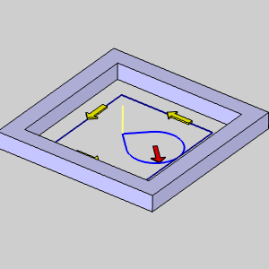

Leads
Material Entry
  • Plunge - generates a plunge feed move into the beginning of the lead-in type.
Leads
The 2 Axis Leads
The 2 Axis Leads
This topic explains the leads options and parameters for the 2 Axis operations: Profile Rough, Profile Finish, Chamfer Mill, and Corner Round. The leads parameters for all other 2 Axis operations are explained in their respective topics.
Using Machine Compensation with Leads: When defining lead moves that use a radius (Circular or Blend), the Radius value of the lead move must be equal or greater than the tool radius to avoid an error at the machine control. Also, for any lead type, Machine Compensation requires a linear move with a length that is equal or greater than the tool radius in order to properly apply the tool compensation commands.
Entry
Lead-in
Click the name of each lead type in the following descriptions to view an example image.

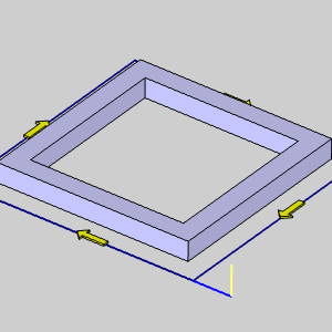

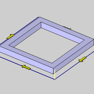

  • ClosedVertical - generates a plunge feed move into the feature.
The Vertical Lead-in type is not actually a lead-in as it only creates a plunge move into the feature. Most machine controllers cannot apply compensation commands to a vertical plunge (Z-axis) move. (G41/G42 are not output when using the Vertical Lead-in.)

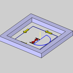

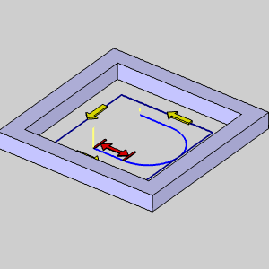

  • ClosedParallel - generates a linear feed move into the feature parallel to the toolpath using the specified length.
    • Length - sets the length of the lead-in from the feature.
  • ClosedRight Angle - generates a linear feed at a right angle to the toolpath using the specified length.

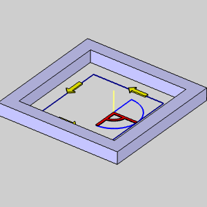

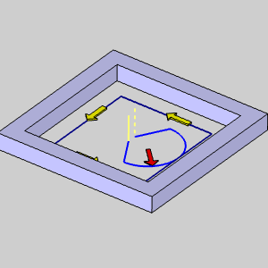

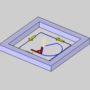

  • ClosedCircular - creates a linear move followed by an arc sweep into the start of the feature. You have complete control over both the line move and the arc move using the following settings.
    • Right Angle - sets the Angle of the line at 90.00 degrees to the start of the arc.
    • Tangent - sets the Angle of the line to 0.00 degrees to the arc to make the line and arc tangent.
    • User Defined - enables the Angle parameter for you to customize the angle of the circular lead.
The three previous options all provide the following settings to define the lead-in.
Line
      • ClosedAngle - sets the angle of the line move into the start of the arc move when using User Defined.
      • ClosedLength - sets the length of the line segment for the lead-in move.
Arc
      • ClosedRadius - sets the radius of the arc sweep into the start of the feature.
      • ClosedSweep Angle - sets the length of the sweep based on the angle of the arc.

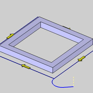

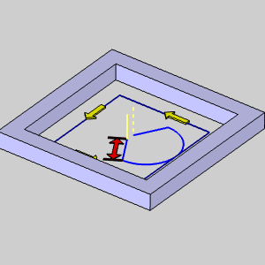

  • ClosedBlend - generates a linear move and then an arc move into the feature. This lead type can be used to lead-in and lead-out of the feature from the same point. The blend lead type creates a tangent path into the feature.
    • ClosedLength - sets the distance of the line segment that connects previous to the arc sweep into the feature.
    • ClosedRadius - sets the radius of the lead move into the start of the feature.
Lead-out
  • Same As Lead-in
Select this check box to use the Lead-in settings to automatically set the Lead-out settings.
Clear the check box to set the Lead-out independently from the Lead-in.
  • ClosedVertical - generates a plunge feed move out of the feature.
The Vertical Lead-out type is not actually a lead-out as it only creates a vertical retract out of the feature. Most machine controllers cannot apply compensation commands to a vertical retract (Z-axis) move. (G41/G42 are not output when using the Vertical Lead-out.)

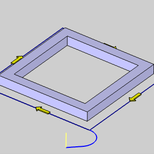

  • ClosedParallel - generates a linear feed move out of the feature.
    • Length - sets the length of the lead-out from the feature.

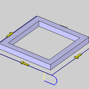

  • ClosedRight Angle - generates a lead-out at a right angle to the toolpath.

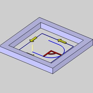

  • ClosedCircular - creates an arc sweep followed by a linear move out of the feature. You have complete control over both the line move and the arc move using the following settings.
    • Right Angle - sets the Angle of the line at 90.00 degrees to the end of the arc.
The three previous options all provide the following settings to define the lead-out.
Line
      • ClosedAngle- sets the angle of the line move at the end of the arc sweep when using User Defined.
      • ClosedLength - sets the length of the line segment for the lead-out move.
Arc
      • ClosedRadius - sets the radius of the arc sweep out of the feature.
  • ClosedBlend - generates a linear move and then an arc move out of the feature. This lead type can be used to lead-in and lead-out of the feature from the same point. The blend lead type creates a tangent path out of the feature.
    • ClosedLength - sets the distance of the line segment that connects to the end of the arc sweep out of the feature.
    • ClosedRadius- sets the radius of the lead move out of the feature.

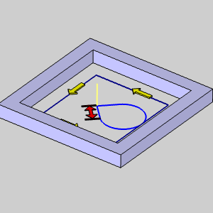

  • Overlap Amount - sets the length of overlap between the start point and end point of the toolpath to change the lead-in and lead-out locations.
