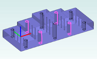

What is a Hole Group?
A Hole Group can be one or more holes that share three parameters: Diameter, Top of Feature, and Feature Depth. All holes that you select for a feature that share these parameters are automatically placed into a single Hole Group. Read the following section for further hole group requirements for each drilling type.
Standard Drilling
The following images show a standard drilling part with holes at three different levels on the model and two hole diameters. The hole groups for this part are shown with the same color.
Notice the holes that share the same diameter, top of feature, and feature depth have the same color. The software automatically creates the Hole Groups as shown after selecting all of the holes for a single drilling feature.
