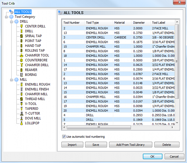

The left side of the dialog box contains the All Tools list and the tools are grouped by Tool Category: Drill, Mill, Lathe, Laser, Plasma, or Waterjet. When a tool is selected from a tool category on the left, all pre-loaded tools for that tool type are displayed in the Tool Parameters list on the right side. You can also click All Tools.
Note: When the Tool Crib is accessed by clicking Tool Crib from a CAM Wizard Tool dialog box, the list automatically shows only the available tools for that operation type.

When using the Tool Crib, select a category on the left side of the dialog box, and then select a tool type under that category. You can also click All Tools. The available tools are displayed in the Tool Parameters list on the right side. The Tool Parameters list shows the parameters of each tool as defined in the Tool Library.
Tool Parameters
  • Use automatic tool numbering
Select this check box to allow the system to number the tools in the order they appear in the posted NC program. This option ignores the tool numbers assigned in the Tool Library.
Click to clear this check box to manually number all of the tools for the program. Once the check box is cleared, double-click the desired tool row. The tool number box becomes available for you to type a new number. Renumbering tools from this location does not change the number of the tool stored in the Tool Library. With this option, any tools from the Tool Library (called System Tools) use the number assigned to the tool in the Tool Library. Be aware that if you create any tools in a CAM Wizard (called Manual Tools), the software numbers them using the next available tool number at the time created. You must confirm that all tools are using the desired tool number before posting the final NC program. Note that the software can't eliminate duplicate tool numbers when using this method, it is your responsibility.
  • Import - displays the Open dialog box for you to navigate to and load a previously saved Tool Crib file (.mtcribs).
  • Save - displays the Save As dialog box for you to create and save all current tool information from the Tool Crib in a .mtcribs file.
  • Add From Tool Library - opens the Select Tool (Tool Library) dialog box for you to add tools. Select the desired tool from the Tool Parameters list on the right side of the dialog box and click OK. The selected tool is added to the Tool Crib.
  • Delete - removes the selected tool from the Tool Crib.
