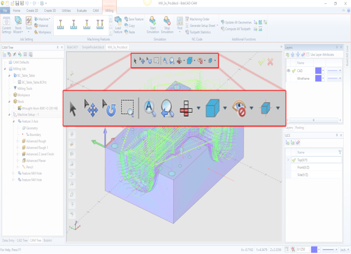

The Document Toolbar allows you to have the view options for the graphics area available to you no matter what ribbon is currently in use.
The Document Toolbar options

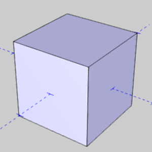

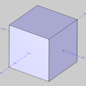

    • Shaded - The Shaded function is used to toggle the view of solids/surfaces, in the graphics area, between a surface view or wireframe view. To perform the function, click Shaded. To return, click Shaded a second time.

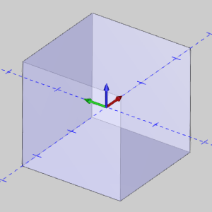

    • Transparent - The Transparent function is used to make solids/surfaces in the graphics area appear transparent (or see through). To perform the function, you click Transparent. To return to the default view, click Transparent again.

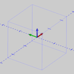

    • Wireframe - The Wireframe View command shows and hides the interior lines of surfaces and solids.

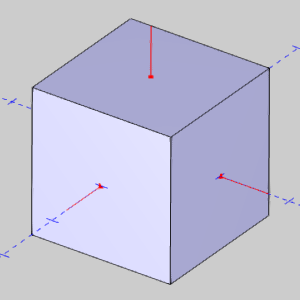

    • Surface Normal - The Surface Normal function is used to show or hide the surface normals of solids/surfaces in the graphics area. This indicates the outward (positive) direction of solids/surfaces. This function is important for creating Multiaxis features. The Reverse Surface Normal Function.

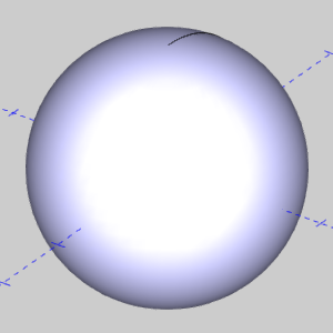

    • Shaded Smooth - The Shading Smooth function is used to smooth the appearance of solids/surfaces in the graphics area. This is turned on by default. To turn the function off, click Shading Smooth. To return to the default view, click Shading Smooth again.

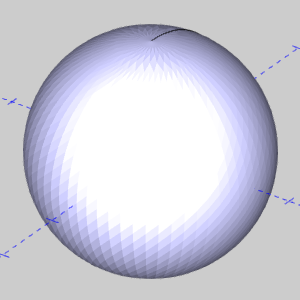

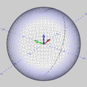

    • Polygon Shaded - The Polygon Shaded function is the default view used for solid/surface entities. They appear as a shaded solid/surface. The Polygon Lines function is used to change this view to a triangle mesh.
    • Polygon Lines - The Polygon Lines function is used to show the triangle mesh of solid/surface entities in the graphics area. When you click Polygon Lines, the view of the solid is updated. To return to the shaded view, click Polygon Shaded.
