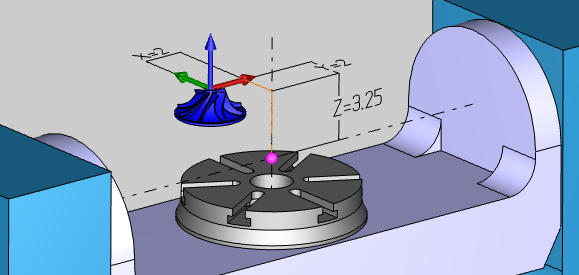

  • Work Offset - opens the Work Offset dialog box. Select the Work Offset # used for this Machine Setup. All milling features that are added to the selected Machine Setup use this value as the default.
    • The X, Y, and Z boxes are used to define the distance from the machine zero to the selected Machine Setup coordinate system. An example of this is shown in the next image.
  • Clearance Plane - sets the value used for the clearance plane in all milling features created under the selected Machine Setup. This is the safe rapid distance between operations as an incremental value from the top of stock for the program.
