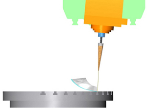

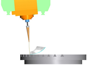

For many 5-axis machines there are two possible solutions to any point in a toolpath. The solution here refers to the angles used for each rotational axis. The following images show a part with the two possible Angle Pair solutions (this is the tool orientation for the toolpath starting point). The tool orientation to the part is the same in each situation; however, the table is rotated 180 degrees. The Angle Pair options control which solution is used. The purpose of the Auto Angle Pair is to use the solution that creates the least amount of tool-axis orientation change from the previous toolpath position. Keep in mind that some machines can't use both pairs based on rotational limits.
Two Solutions

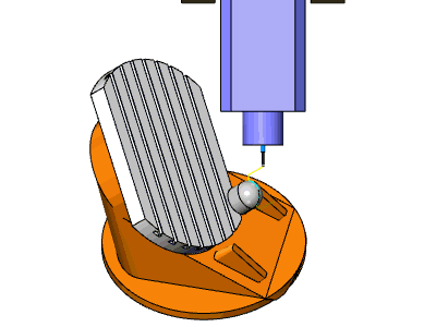

When a five axis machine is used to run a 3-axis toolpath, there are certain situations that make the C-axis value arbitrary. What this means is that by changing the X- and Y-axis values appropriately, any C-axis value used creates the same results. For example, when a cylinder is located in the center of the table, depending on the machine, there are multiple ways to cut the profile of the cylinder. The rotation axis can be fixed while the linear axes are used to cut the part. On the other hand, the linear movements can be fixed, while the table is allowed to rotate in order to cut the part. This situation where the C-value is arbitrary, because the spindle direction and the table direction are collinear, is called a singularity or pole. The Pole Handling options are used to control these situations as follows.
  • Freeze Angle Around Pole - fixes the rotational axis in order to use the linear axes movements.
ClosedView an example

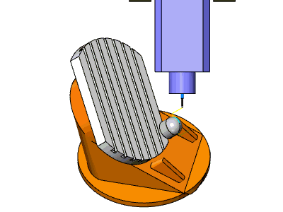

  • Linear Interpolation of Rotation Angle Around Pole - calculates rotational axis values to make the changes from one value to the next in a linear fashion. The linear distribution is based on the tool tip position from one toolpath point to the next. This is useful when a 3-axis toolpath is converted to a 5-axis toolpath. For example, when a toolpath transitions from linear motions to rotational motions (from 3-axis to 5-axis), an abrupt change can result because of the conversion. This option is used to avoid these abrupt changes by setting a constant (linear) rate of change for the rotational axis.
ClosedView an example without Linear Interpolation
ClosedView an example with Linear Interpolation

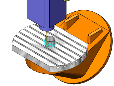

  • Smooth Interpolation of Rotation Angle Around Pole - similar to Linear Interpolation, this option also manipulates the table rotation speed to create a more fluent transition.
ClosedView an example without Smooth Interpolation
ClosedView an example with Smooth Interpolation
