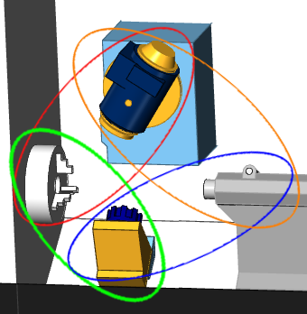

The Submachine page of the Current Settings displays when you select a mill-turn machine in the machine parameters. There are two groups in the submachine page: Devices and Parameters. The Devices group displays a tree structure that contains the machine, its devices, and submachines (work zones). The Parameters group is used to edit the parameters of the currently selected tree item.
The machine and the devices are automatically populated from the machine definition. The devices are a collection of machine components that work together to hold either the workpiece or tools, thus there are two device types: workpiece devices or tool devices. A workpiece device is a lathe spindle, or chuck, and a tool device may be a turret or a milling spindle. A submachine (work zone) is a combination of one workpiece device and one tool device. The submachine determines which machine devices/components work together to perform machining operations (work zone). You define the submachines based on how many potential device combinations exist on the physical machine.

Submachines - Device Grouping
