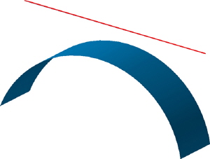

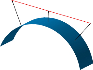

A simple curved face with a projection curve (red) above. The curve lies within the max projection distance.

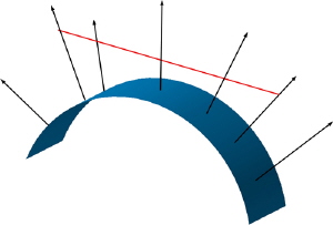

For the projection, some surface normals (black) intersect with the curve.
Only the intersecting surface normals are used for the projection.

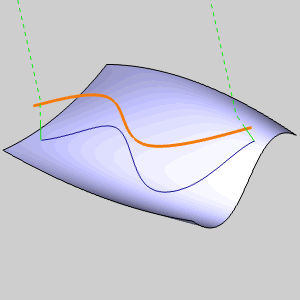

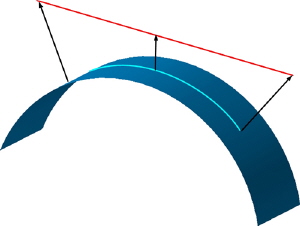

The curve projected onto the drive surface.

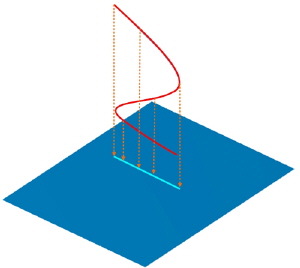

A vertical spline curve projected onto the drive surface creates a line.
