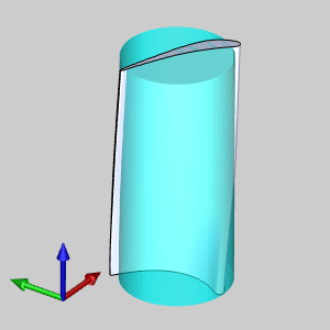

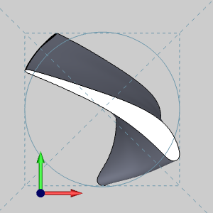

  • Bounding Box - sets the stock by using the extents of the selected Geometry Option to create a bounding box that will center the stock. The diameter of the stock is then equal to the longest side of the rectangular bounding box.

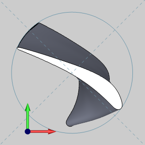

Warning: While the default Bounding Box option works fine in most cases, the image above shows a scenario in which it fails to enclose all of the geometry in the cylindrical stock. The Bounding Box  is shown with dotted lines. Notice that the Bounding Box itself encloses the geometry, while the arc that is created fails to.

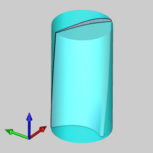

  • Bounding Cylinder -  uses an algorithm to calculate the smallest possible cylinder to enclose the geometry selected with the Geometry Option to create stock.
