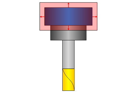

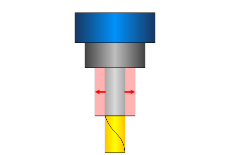

Cylindrical - will define a cylindrical boundary around each of the specified components with the values specified below.
Clearance values - define the clearance area around each of the individual components.
Shaft - sets the perpendicular distance from the shaft that will define the cylindrical clearance area around it.
ClosedClick here to see an example of Shaft Clearance
Arbor - sets the perpendicular distance from the arbor that will define the cylindrical clearance area around it.
ClosedClick here to see an example of Arbor Clearance

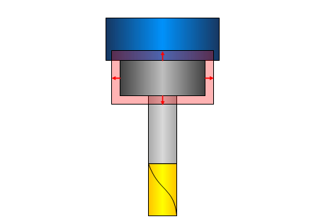

Holder - sets the perpendicular distance from the holder that will define the cylindrical clearance area around it.
ClosedClick here to see an example of Holder Clearance

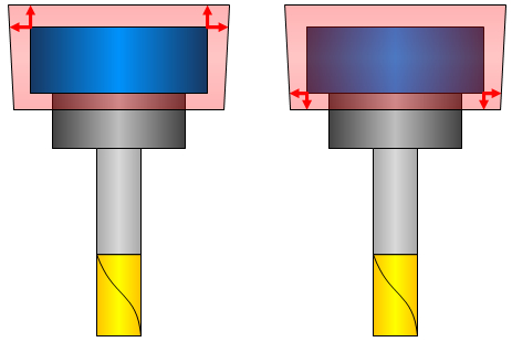

Conical - will define a conical boundary around each of the specified components with the values specified below.

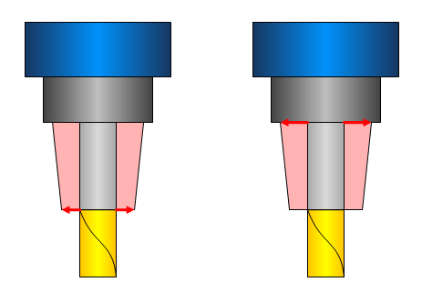

Shaft - defines the conical clearance area around the shaft.
Lower Offset - sets the perpendicular distance from the bottom of the shaft to define the conical clearance area.
Upper Offset - sets the perpendicular distance from the top of the shaft to define the conical clearance area.
ClosedClick here to see an example of Conical Shaft Clearance

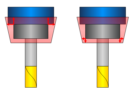

Arbor - defines the conical clearance area around the arbor.
Lower Offset - sets the perpendicular distance from the bottom of the arbor to define the conical clearance area.
Upper Offset - sets the perpendicular distance from the top of the arbor to define the conical clearance area.
ClosedClick here to see an example of Conical Arbor Clearance
Holder - defines the conical clearance area around the holder.
Lower Offset - sets the perpendicular distance from the bottom of the holder to define the conical clearance area.
Upper Offset - sets the perpendicular distance from the top of the holder to define the conical clearance area.
ClosedClick here to see an example of Conical Holder Clearance

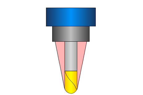

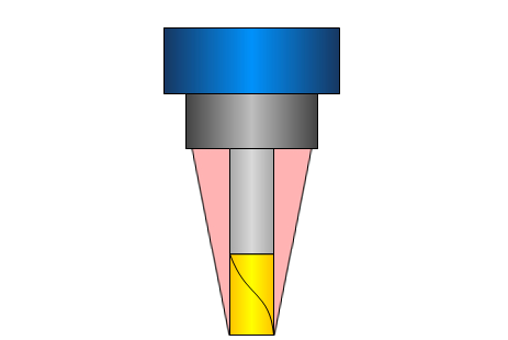

Angular clearance - creates a conical clearance area around the tool. The angles origin varies based on the type of tool selected. In the case of a flat end mill, the angle will originate from the bottom diameter of the tool. In the case of an end mill with a radius, the angle will originate from the tangency of the radius.
ClosedClick here to see an example of the Angular clearance
When using Angular clearance in conjunction with clearance values, clearance values will extend the area of angular clearance. ClosedClick here to see an example.
