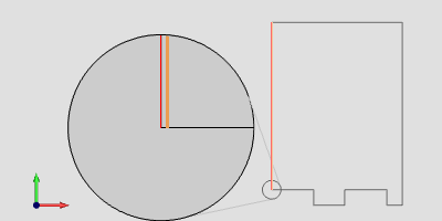

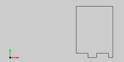

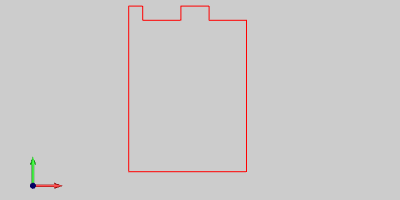

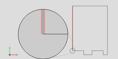

The first thing to keep in mind is that we cut this shape out. Every cut has a width to it. When we cut this remnant out in the last tutorial we cut the line with no compensation, which removed material from the left and the right of the line. Note in the image below, this is shown in red.
Cut Line | Cut Line Magnified |
In a nest with little to no margin, not taking this cut into account could ruin parts.

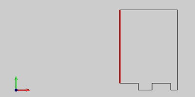

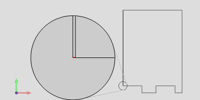

Line and click
Line Parallel.

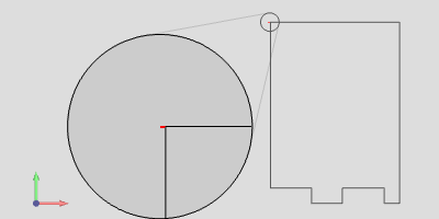

Since we used a 0.2500 inch diameter tool to cut free the sheet, set the Distance value to 0.1250.
Click on the vertical line to the left, drag your mouse a little to the right, to choose the right side of the line to create the parallel line, and click your mouse again to finalize.
Parallel Line Preview | Parallel Line Preview Magnified |

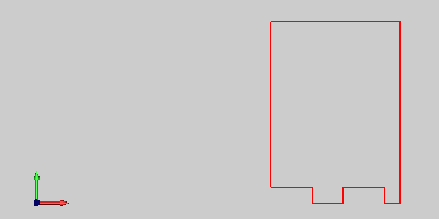

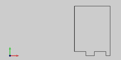

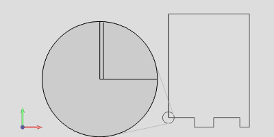

Now that we have created the proper line, we need to trim off the remainder. In the Trim Extend group of the Utilities ribbon, click
Quick Trim.
Parallel Line | Parallel Line Magnified |
Now that we have the
Quick Trim feature
active, click the segments that need to be eliminated.

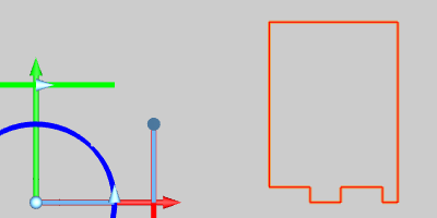

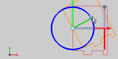

The WCS in the CAD window will also be our Machine Zero for the nest. We need to move this sheet to place it in relation to the WCS as the actual sheet will be to the machine zero. We will have the top left of our sheet as our origin and nest in the X+,Y+ quadrant. In order to accomplish this, we will need to rotate the part 180º and move it to the WCS.
In the Move group of the Utilities ribbon, click
Rotate.Hover your mouse over one of the lines of our remnant shape, hold shift on your keyboard and then left-click to chain-select the entire chain. The entire chain should now be highlighted.
Press the Spacebar on your keyboard or right-click inside of the CAD window and select
OK to finalize
geometry selection.

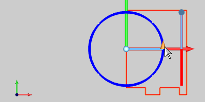

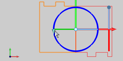

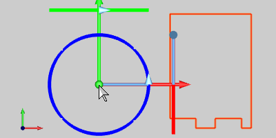

The rotation sketch handles appear and we now need to define the degree of rotation and the center of that rotation. This can be done using the data entry or the sketch handles themselves. We will use the sketch handles in this lesson. First, click the center of the sketch handles to alter its origin.
You are now free to move your mouse around to alter the origin of rotation. Hover your mouse over the middle of the left line of the remnant shape and left-click.

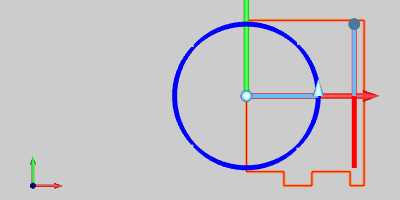

Left-click the arrow on the blue, X axis rotation handle to alter the degree of rotation.

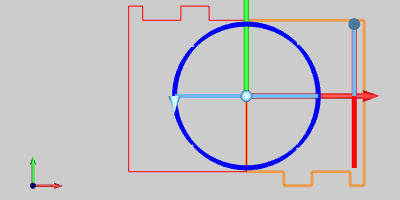

Bring the handle counter-clockwise to the 180º location, left-click once to set that location, then press the Spacebar on your keyboard to finalize.
Cancel out of the
Rotate
feature.

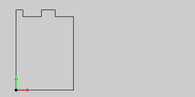

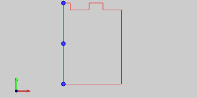

Translate.Select the Sketch/Enter option at the top. This will allow us to set the Start point with a Pick or Enter method. This will also allow us to set the End point with a Pick or Enter method. By default, the Sketch/Enter option will be set to Pick the start point and Enter the End value. Also by default, the End value will be set to X 0.0000, Y0.0000, Z0.0000. This is convenient for us since that is where we want to place the corner of our shape.

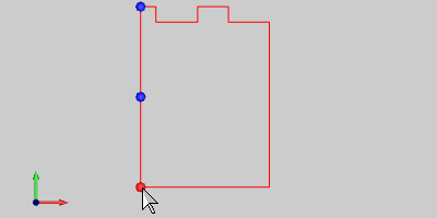

The next step in the translation process is to pick the start point. Since we have the end point set to Enter, the next point we pick will be translated to X 0.0000, Y0.0000, Z0.0000. Hover your mouse over the line on the left of the shape, hold shift on your keyboard and left-click it once to display the snap points.
Left-click the snap point on the bottom.
Our remnant shape is now aligned with the WCS as we will have it set to the Machining Origin on our machine. Press cancel to exit the

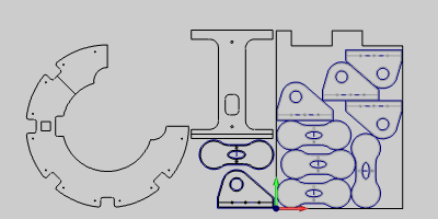

We will be leaving the other settings at default. Click Compute at the bottom left of the wizard.
Part 8) Checking the Result
Now that the nest has been regenerated, we will want to check to see if the change we made to the Nesting Parameters has helped eliminate leftover parts.
In the CAM Tree, right-click on
Sheets and select Show Summary. Here we can see we have no leftover parts.
Click OK at the bottom of the Nesting Summary to close it.
