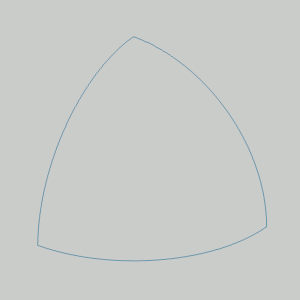

The 3 Edge Surface function creates a 3-dimensional surface using 3 connected edge curves. To perform the function, you chain select the three geometry curves in the Workspace one at a time, and then press the Spacebar to confirm the selections. The direction of the selected chains control the outcome of the surface so the chains should follow the same direction.

When creating 3 Edge Surface, you chain select each of the three surface edges. Each chain can be one or more entities. The selection order determines the results, and the chains should all share the same general direction, such as clockwise.

  3. Highlight the end of the first entity, of the first chain, as seen in the image below.
Note: In this example, each chain is a single entity. If these chains were multiple entities, the steps would be the same; Click the end of the first entity of the first chain to set the start point and direction of the chain. Then hold Shift and click the end of the last entity of the first chain to set the end of the chain. Then repeat for the second and third chains.
  1. Click the entity to set the start of the chain.
  2. Highlight the end of the chain as seen in the image below.
  3. Press and hold Shift on the end of the entity to set the end of the chain.
Tip: While selecting the geometry for a 3 Edge, you can click the start arrow to change the direction of that cross section, or use the Reverse button after highlighting that chain in the Selected Geometry list of the 3 Edge Surface parameters  in the Data Entry Manager. It is important that all of the chains share the same direction.
  1. Hover over the end of the next chain, as seen in the image below.
  2. Click the entity to set the start of the second chain.
  3. Highlight the end of the chain as seen in the image below.
  4. Press and hold Shift on the end of the entity to set the end of the chain.
  5. Hover over the end of the next chain, as seen in the image below.
  6. Click the entity to set the start of the second chain.
  7. Highlight the end of the chain as seen in the image below.
  8. Press and hold Shift on the end of the entity to set the end of the chain.
    The Preview appears.
  9. Click OK to finalize the 3 Edge.
    The surface is created and a 3 Edge feature is created in the CAD Tree.
  10. To end the function, click Cancel.
