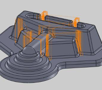

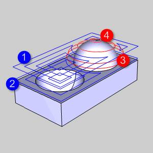

Rest Roughing
Calculates the toolpath to remove all the non-machined areas remaining
from the previous roughing tool. The previous tool is used to
identify accurately the areas on a 3D component by sweeping the diameter
across the whole part being machined. In this way any non-machined
areas are identified and passed to the system and the toolpath is
calculated. The Rest Roughing toolpath does not require the whole
part to be machined again. It machines only those areas that are left
behind by the previous tool. On intricate parts, multiple rest rough
toolpaths are required to remove as much material as possible before
running semi finishing or finishing toolpaths. In Rest Roughing toolpaths
you normally use a smaller step down (as the cutter size reduces)
than the cutter used for the previous roughing toolpath. The following
is an example of using the Advanced
Rough feature for rest machining,
along with an image showing the rest roughing strategy in blue.

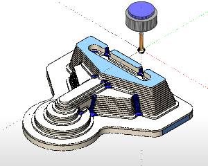

Machine Flatlands
Flatlands
is designed to finish flat areas of a part, and it is best suited for
machining large flat areas at multiple Z-levels.
- Clear this check
box to not allow flatland machining.
- Select this check
box to allow flatland detection which creates an optimized finishing toolpath
for flat areas.
- Min.
Width of Flatlands - sets the minimum width of flat areas that
are included in the flatlands machining.
- Max. Width
of Flatlands - sets the maximum
width of flat areas that are included in the flatlands machining.
- Clear the check box to only set a minimum width of flat areas that are included.
- Select the check box to set a maximum width of flat areas that are included.
Important: The Flatlands feature must use flat-end mills or bullnose mills.

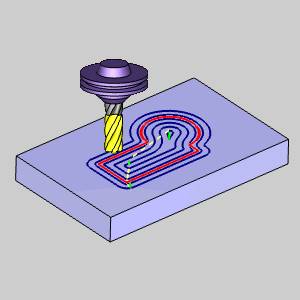

Boundary Options
Boundaries are used to contain the toolpath of the operation to stay within the specified area. The Boundary Options determine where the tool cuts when it reaches the boundary in one of three ways.
Center of Tool - forces the center of the tool to cut directly on the specified boundary.
Tool Inside - forces the entire tool to stay inside of the boundary. (This offsets the toolpath to the inside of the boundary by the tool radius.)
- Offset - is used to add an additional offset to the location of the tool at the boundary when using Tool Inside or Tool Outside. When using Tool Inside, the tool stays inside of the boundary by the specified distance. When using Tool Outside, the tool goes outside of the boundary by the specified distance. Note that positive or negative values are supported.
Tool Outside - forces the entire tool to go outside of the boundary. (This offsets the toolpath to the outside of the boundary by the tool radius.)

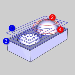

Sorting
By Area - machines an entire area of the part before moving on to the next.
By Level - machines all areas of the part to the current pass depth before beginning the next pass.
