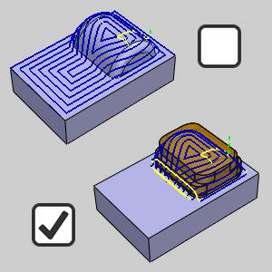

  • Machine Flatlands
    - Clear the check box to turn off Machine Flatlands.
    - Select the check box to turn on Machine Flatlands and create an optimized finishing path for flat areas of the model. This option adds a pass to cut the flat areas of the finishing operation.

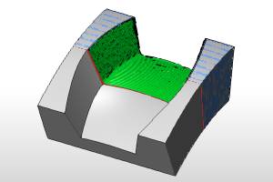

  • Machine Vertical Walls Only
    - Clear the check box to machine the entire feature.
    - Select the check box to apply toolpath to only the vertical walls of the feature. This alters the calculation to remove the toolpath from all non-vertical areas of the feature. (When this option is selected, the Adaptive Depth of Cut becomes unavailable as it does not apply to machining vertical walls.)

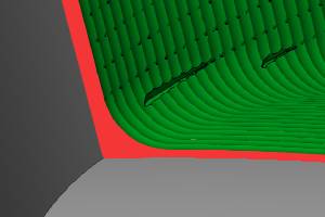

  • Adaptive Depth of Cut - When this option is selected, the Machine Flatlands option becomes unavailable as the Adaptive Depth of Cut also performs the Machine Flatlands function.
    - Clear the check box to turn off Adaptive Depth of Cut.
    - Select the check box to turn on Adaptive Depth of Cut. This helps the operation to cut shallow areas of the model better by adding more passes to create a better finish.

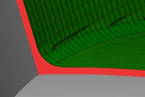

  •  Trim adaptive depth step passes - when this option is selected, the Adaptive Depth of Cut result is trimmed to the remove excessive cuts from areas they are not needed.
    - Clear the check box to turn off the Trim adaptive depth step passes.
    - Select the check box to turn on Trim adaptive depth step passes. This localizes the adaptive depth of cut to the areas in which it is required.
