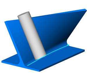

Swarf Machining

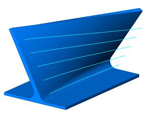

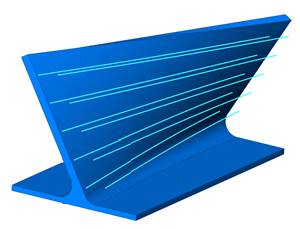

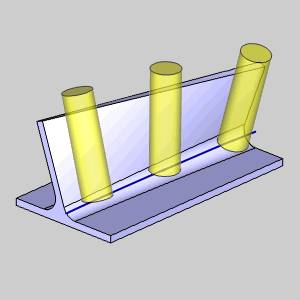

The Swarf feature, also called flank milling, is helpful for machining fluid parts such as impellers or bladed disks (blisks). This toolpath can be used for any type of operation in which you want to cut using the entire length of the tool flute. The goal of swarf milling is to produce the target surface with one cut. The feature geometry requires either a Swarf Surface and/or an Upper Curve and Lower Curve, based on the strategy used. When selecting Swarf Surfaces, you can omit the Upper and Lower Curve. When not selecting the Swarf Surfaces, you must select the Upper and Lower Curves. You can also select all three.

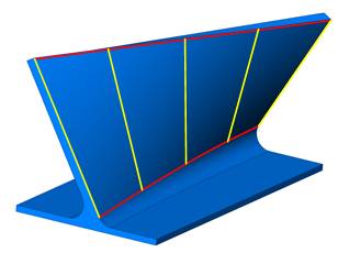

Tilt lines - can be selected to define the orientation of the tool along the cut. Tilt lines are only used with the Sync with Tilt Lines strategy.
Guide Curves
You can select the Guide Curves check box to turn on the ability to select guide curve geometry.
Upper - is the upper edge curve of the feature which is used to define the upper point for the tool orientation and is used when applying a Swarf Offset. Generally, this is the upper edge of the Swarf surfaces.
Lower - is the lower edge curve of the feature which is used to define the lower point for the tool orientation and is used when applying a Swarf Offset. Generally, this should be the lower edge of the Swarf surfaces. The chain direction (Start Point) of the lower curve can be used to set the cutting direction and cutting side of the feature.

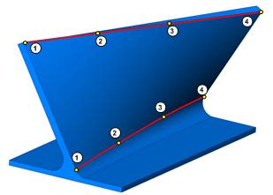

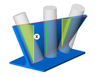

Sync with tilt lines - select this option when using tilt lines between the upper and lower curves along the surface. You must select the tilt lines used.
Sync with (upper/lower) curves - select this option when using the upper and lower curve. Each curve is split into equal distances and the points are used for the tool alignment. This is a commonly used strategy that works best when the shape and length of the upper and lower curves are similar.

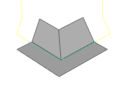

Shortest Distance - select this option to allow the system to define the tool orientation using the shortest distance between the upper and lower curves. This strategy is helpful when machining flat surfaces with sharp corners.

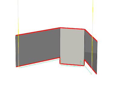

Fanning Distance - for use only with the Shortest Distance strategy, this is the distance from the intersection of two surfaces. Within this distance, the tool axis orientation begins to tilt. This helps to avoid sudden tool axis orientation changes.

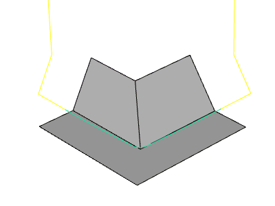

The following example shows fanning with
a value of zero. When the top of the tool reaches the corner it stops
while the bottom of the tool continues to fan around the corner. This
is a result of the upper and lower curve not having the same length.
View Fanning Distance at Zero

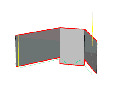

The
following example shows the fanning distance set to a larger value to
cause the tool to more smoothly through the corner.
View Large
Fanning Distance

Corners
Inside Corners
Sharp Corner - creates sharp corners using orthogonal linear moves.
Round Corner - creates round corners using an arc move.
Radius - defines the radius used for the round corner.
Detection Angle - is the angle value used to detect corners to apply a round corner.
Relief Curve - cuts into the corner based on the length and detection angle settings.
Length - is a distance the tool travels into the corner.
Detection Angle - is the angle value used to detect corners for the relief curve.
Outside Corners
Roll Around - handles corners using an arc move.
Detection Angle - is the angle value used to detect corners to apply a sharp corner.
Loop - creates a loop move at each corner using the radius and detection angle settings.
Radius - is the radius of the loop move.
Detection Angle - is the angle value used to detect corners for the loop.
