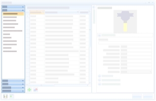

Tool Library Interface
Tool Panel Bar
The left-most portion of the Tool Library is the Tool Panel Bar which groups the tools. The tool are divided first by Drill, Mill, Lathe, Laser, Plasma, and Waterjet. Clicking on a particular group will display the available tool types in that group. Finally, clicking on a particular tool type will show all the tools available tools of that type.

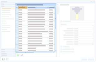

Tool Grid View
With a particular tool type selected, the Tool Grid View will show all the available tools of that type. From this point you can add tools, or highlight a particular tool to delete it.

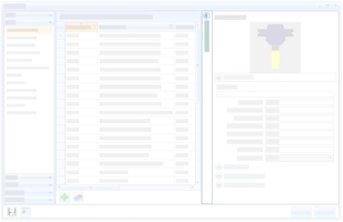

Tool Parameter Grid Splitter

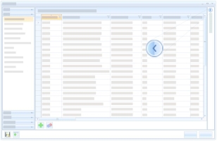

Upon opening the Tool Library, the Tool Parameter Dialog will be collapsed. To expand the Tool Parameter Dialog, click the
 chevron icon. With the Tool Parameter Dialog expanded, click the
 chevron icon to collapse it. The Tool Parameter Grid Splitter can also be used to resize the Tool Parameter Dialog. Hover over the left side of the Tool Parameter Grid Splitter until the mouse icon displays as the double headed arrow. You can then hold left-click and drag the dialog to the desired size.

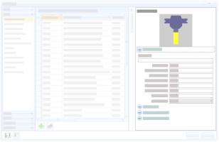

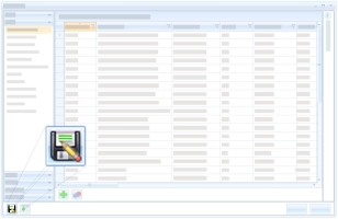

Saving the Library
Libraries can be saved in order to share the library between work stations, or can be saved to move your library from an older version of Bob
To save your tool library:
- Click the
 Save As button on the bottom left.
The Save As dialog appears. - Choose a name and a location for the file.
 - Click Save.
The file is saved.

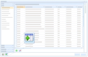

Importing a Library
To use an existing library:
- Click the
 Import from file button on the bottom left.
The Open dialog appears. - Locate and highlight the appropriate file.
 - Click Open.
The library is updated based on the imported file.

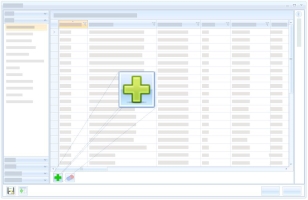

Adding a Tool
- Click the
 Add button at the bottom left of the tool list.
This tool is now in the Tool Parameter Dailog to allow for editing.
Editing a Tool
- Click the chevron next to the Tool Parameter Dialog to automatically expand it.
You can also do this manually by hovering over the right side of the Tool Grid View and dragging it into position once the double headed arrow icon appears. - Edit the desired Tool Parameters.
 - Select another tool in the Tool Grid View to update the edited tool data in the Tool Grid View, and to select another tool to edit.
 - Repeat steps 2 & 3 as needed.
 - With all tools edited as needed, click OK.

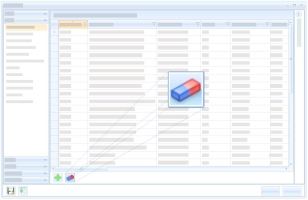

Deleting a Tool
- Highlight the desired tool.
 - Click the
 Delete icon.
A message box appears asking: Are you sure you want to delete this tool? - Click Yes.
