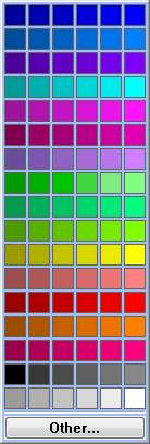

To the right of the XYZ indicators is the Active Color Selector. This box displays the current color that is used for creating wireframe entities. To change the active color, click the arrow and select the new color.
