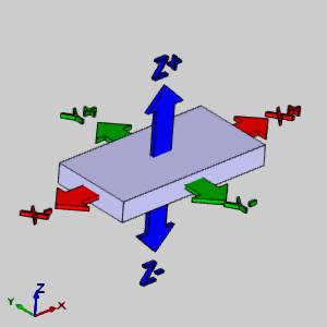

Part 4) Add an Offset to the Stock
Because the part is being cut from stock that is larger than the bounding stock, an offset is added to increase the size. A diagram of the Offset directions follows.
Offset Diagram
  • -X - the negative X-axis direction.
  • +X - the positive X-axis direction.
  • -Y - the negative Y-axis direction.
  • +Y - the positive Y-axis direction.
  • -Z - the negative Z-axis direction.
  • +Z - the positive Z-axis direction.
  1. In the Dimension / Offset group, enter the values as follows.
  X Y Z
Offset + 0.2500 0.2500 0.0000
Offset - 0.2500 0.2500 0.0000
The stock is now 0.2500 larger on all four sides.
