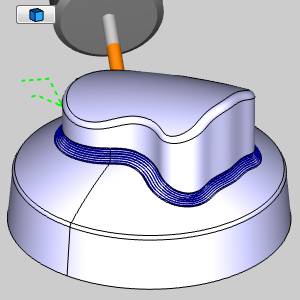

On our example part, we have created an Morph between 2 curves toolpath. In this case, while the toopath on the main fillet is good, the tilt of the tool could use a little adjustment in particular areas. We will use the Backplot feature to get a preview of the tool movement and tilt.
  1. In the CAM Tree, right-click the Multiaxis operation of the Feature Multiaxis.
  2. Select Backplot.
  3. Press Play to begin backplotting the operation.
  4. Adjust the Speed, Progress sliders, and the view in the graphics area as necessary.

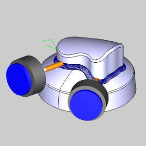

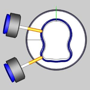

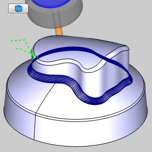

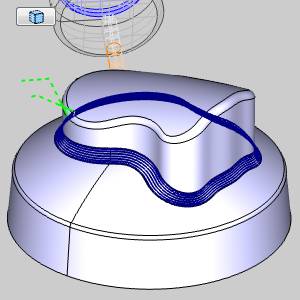

    Take a moment to analyze the tool axis as it moves around the part, paying special attention to the area in the images below.
    You can see, in the indented area on the side of the part, the axis of the tool crosses over itself. In this example, we will edit the area seen in the above image and have the tool axis, instead, move smoothly between the two tool axes seen in the images below.

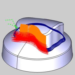

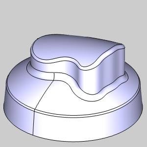

  1. Press Ctrl+7 to get into an ISO 2 view.
  2. Select the Polygon Pick option below the Selected Toolpath Elements list.

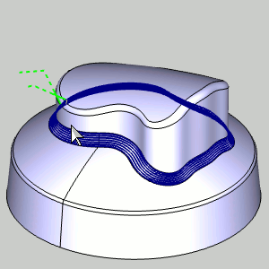

  3. Select four points, as seen in the image below, to create a polygon around the area we intend to affect.
  1. Right-click and select OK to confirm the selection of our toolpath elements.
    The executable preview displays.

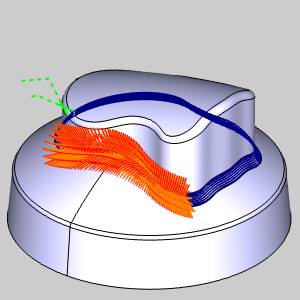

Part 5) Adjusting the Parameters
With the toolpath elements selected, we will need to set the Parameters to define the tool axis of the toolpath elements.
  1. In the Parameters group, click the Direction Interpolation radio button.

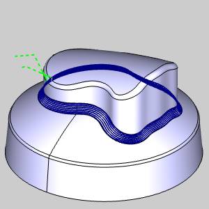

Part 6) Executing the Action
  1.  Click Execute.

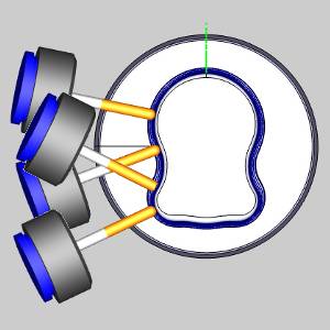

Part 7) Viewing the Animation
  2. Use the Animation controls to play through the animation. With either the (Solid), (Transparent), or (Wireframe) view.
    Notice the tool axis has been updated on one side of the part.
