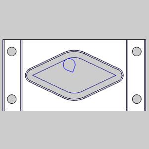

 Take a moment to look at the stock compared to the existing toolpath to see the what we intend to accomplish.
  1. In the CAM Tree, click Stock to view the assigned stock.
    Take a moment to look at the existing stock compared to the existing toolpath to get an idea of why we have broken the toolpath elements.
  2. In the CAM Tree, click the Pocket operation in the feature to remove focus on the stock and to place focus on the toolpath to be adjusted.

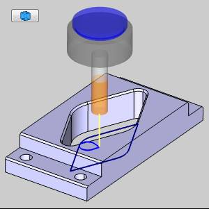

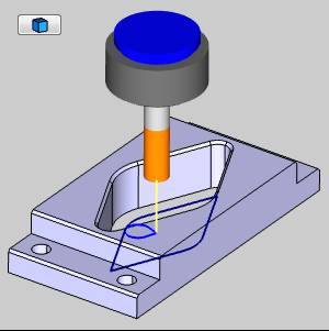

  1. In the graphics area, select the toolpath shown in the images below.

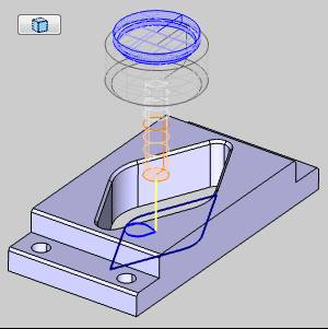

  2. Use the Animation controls to play through the animation. With either the (Solid), (Transparent), or (Wireframe) view.
