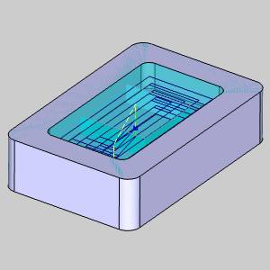

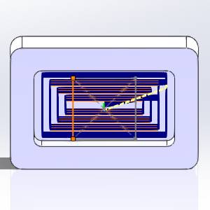

On our example part, we have used asolid model to set the stock to a specific shape. In this case, there is an void in the center of the stock that reaches, nearly all the way, to our intended pocket depth. It is for this reason, it would be beneficial to eliminate the portions of the toolpath that are not engaging material. Take a moment to look at the stock compared to the existing toolpath to see the what we intend to accomplish.
  1. In the CAM Tree, click Stock to view the assigned stock.
    Take a moment to look at the existing stock compared to the existing toolpath to see what we intend to accomplish.

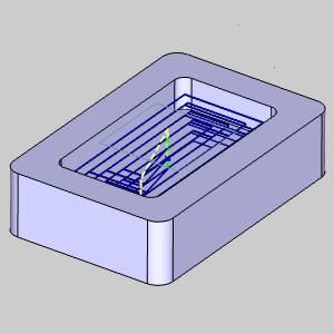

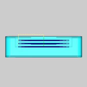

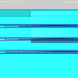

  3. In the document toolbar, select Transparent, or use the keyboard shortcut by pressing T on the keyboard.
    The model becomes transparent, making the toolpath visible in a side view.
  4. Zoom into the pocket.
    Notice the final depth of the pocketing toolpath is not affected by the cavity in our stock. As, such, the first two depths of the pocket are the only ones that will need to be trimmed.

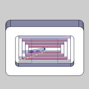

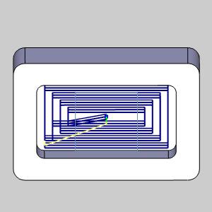

Part 4) Positioning Part for Selecting Toolpath Elements

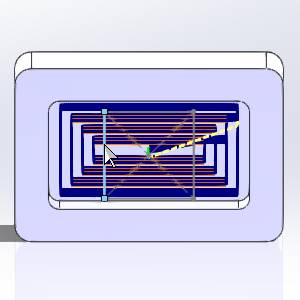

In this case, we are only trying to trim the first two depths of our pocketing toolpath. Because of this, a simple window selection from a top, or side view, will not be ideal. We will rotate the part slightly from a top view to allow us to select each toolpath element individually.
  1. Put the part into a top view by choosing Top View from the View list in the document toolbar.
  2. Rotate the part slightly to acquire a view as seen in the image above.

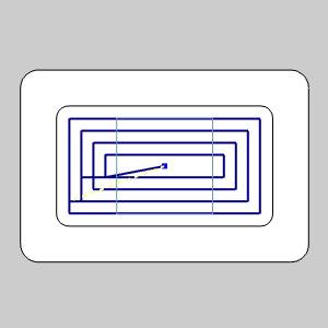

Part 5) Selecting Toolpath Elements

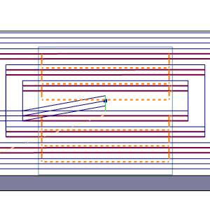

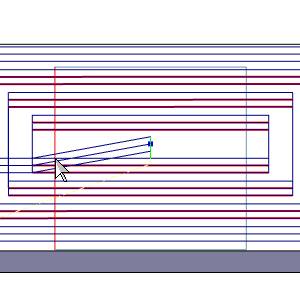

  1. In the graphics area, select the toolpath shown in the images below.

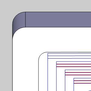

    In the close up image below, notice we are only selecting toolpath elements from the first two depth passes. Although we could also select the first moves of the first and second layers, we leave them out for this example.

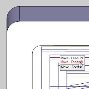

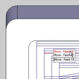

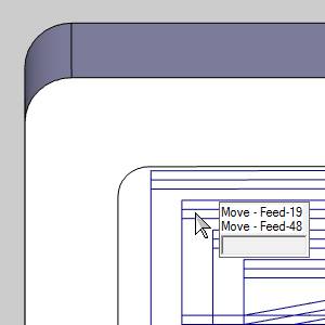

Note: When toolpath elements are close enough together, attempting to select one may cause a dialog to appear. This dialog will allow you to select, from the dialog list, the intended toolpath element, as seen in the images below.

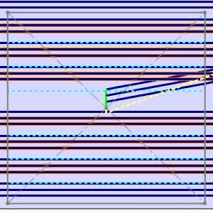

Part 6) Setting the Trim Boundary and Usage

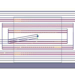

With the toolpath elements selected, we will need to set the Trim Boundary to define which portion of the selected toolpath elements need to be trimmed.
  1. In the Trim Boundary group, next to Usage, select the Along Z option.
    This will ensure that selected toolpath elements are not left untrimmed due to our current view.
  2. In the Trim Boundary group, select the (Click or Drag Window Pick) option.
  3. In the graphics area, hover over an entity of the wireframe geometry. Once the entity highlights, hold shift and select it in order to perform a chain selection.

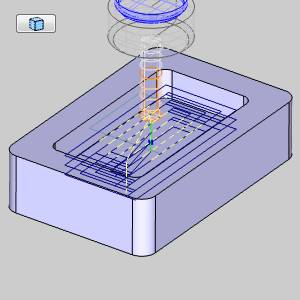

  1. With the Trim Boundary selected, right-click and select OK to confirm selection.

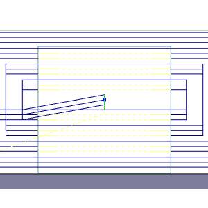

    The preview shows the executable result.
Tip: If all of the toolpath in the Trim Boundary area is to be trimmed, selecting toolpath elements is not necessary, as the Trim Boundary will automatically grab the toolpath elements within it. In this case, that was not possible, as we did not want the last depth pass to be trimmed.
Part 7) Adjusting the Link Options
Now that we have decided what toolpath elements to trim and where to trim them, we have to set the linking options. In this case, we will set the link type to a direct rapid move and adjust the extension value.
  1. Set the Extension value to 60.
    This will give us allowance for our tool radius, so the tool does not rapid into the stock.
  2. Remove focus from the Extension text field, by pressing Tab or clicking in another field
    The preview updates to show the executable results of the current settings.

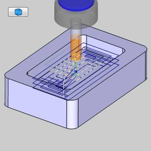

Part 9) Viewing the Animation
  2. Use the Animation controls to play through the animation. With either the (Solid), (Transparent), or (Wireframe) view.
