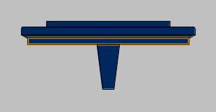

Tip: The center section (V-flange) of the tool holder uses multiple cylinders and cones. To create a chamfer that is not 45 degrees, you use a cone. To create a 45 degree chamfer, you use a cylinder with the chamfer option.

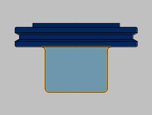

Since the first element of the arbor is a cylinder, in the Element Parameters group, type the following values.

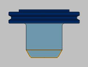

In the Element List, click AddCone, and type the following values.
Tip: The cylinder element (step 4) has a diameter of 1.97 with a bottom fillet of 0.118. The cone element (step 5) has a diameter of 1.97 with a top fillet of 0.118. When two elements share the same diameter where they meet, you can apply a fillet across the two elements. To apply the fillet across the two elements, you must use the same fillet value for each element (Top Fillet of one element and the Bottom fillet of the next).

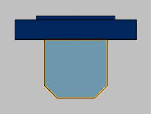

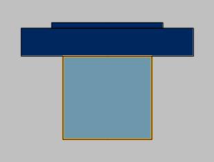

How to Measure Angle Mode
Bottom Angle Mode = 45 degrees |
