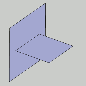

Part 7) Selecting the Geometry
In the Corners group, of the Create 3D tab, click
Surface Fillet.
The Fillet Surface dialog opens in the Data Entry Manager. -
Hover over the surface created on the Front Plane as shown in the image below.
Select the surface.
The surface is added to the First Surface/Solid list.
Hover over the surface created on the Top Plane as shown in the image below.
Select the surface.
The surface is added to the Second Surface/Solid list and the Preview appears showing the result if the default Blend option is used.
