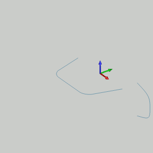

Swung Surface requires two chain selections: the Trajectory Curve or path (on the XY plane) and the Profile Curve (on the XZ plane). You can perform chain selection in one of two ways. You can click to set the starting entity of a chain and then hold Shift and click to set the ending entity of the chain, or you can hold Shift and click the end of the last chain entity. For Swung Surface, you can often use the second method.
In the Parameters group, of the Data Entry Manager, select the Follow Profile Curve option.
- Press and hold Shift
and click to chain select the Trajectory Curve on the XY plane. Click
near either end of the chain.
Notice that the Trajectory Curve is selected on the XY plane of the Active UCS, and that the focus has shifted to the Profile Curve list.
The start and end arrows display to show that the current chain selection is finished. -
Hold Shift and click to chain select the Profile Curve on the XZ plane. (Click near the upper end of the chain.)
Note that the Profile Curve is selected on the XZ plane of the Active UCS.
After chain selecting the profile curve, the CAD preview displays in the Workspace.
Notice the resulting surface. The profile curve follows the trajectory curve while being revolved around the Z-axis of the Active UCS. (Also, the direction of the profile curve does affect the result when using Follow Trajectory Curve as it defines where the profile starts and ends in relation to the path.)

Active UCS and Revolution Axis
As a final note for Swung Surface, the location of the Z-axis of the Active UCS is an important part of the resulting surface as it is the revolution axis for the surface along the path.
The following images show the result of the same wireframe geometry used in the previous example, but created from a different UCS. Note that the following example shows more of a creative use of Swung Surface as it results in scaling or stretching of the surface in the XY plane.
