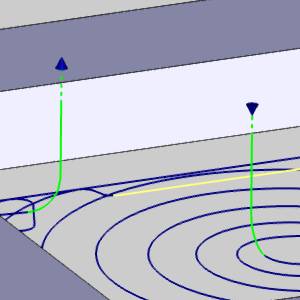

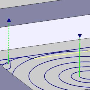

Leads
This Leads section is only available when the Adaptive Roughing Pattern is used. The leads that are available are as follows.
  • Vertical - plunges directly into the material at the start point of the toolpath and lifts out at the end.
  • Vertical Arc - attempts to enter and exit the material tangent to the surface being machined using an vertical arc move.
