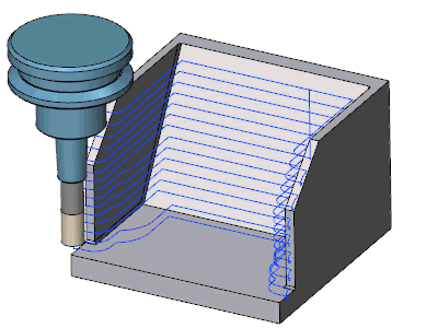

The Gouge Check page allows you to use up to four separate gouge checks. You will be able to select a surface, or surfaces to check, assign an allowance to leave on those surfaces, dictate what to check against, whether that is the tool, or tool and tool holder, and set the strategy to utilize if a gouge is detected.
Note: There is a difference when using the Gouge Checks, and the Check holder with option available in the Advanced Rough operation. When using the Gouge Checks, the toolpath is created, and the Gouge Check is run afterwards. If a gouge is detected, the Strategy is run to correct gouges. When using the Check holder with option in the Advanced Rough, the Gouge Checks are run during the calculation of the toolpath.

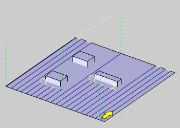

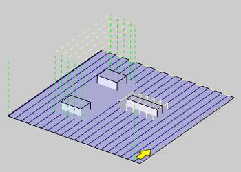

The Strategy sets what is to occur in case there is a collision detected.
  • Retract Tool - will retract the tool and end the operation.

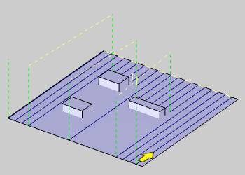

    Trim and Relink - offers options on how to trim and how to trim and relink the toolpath. This option handles each individual tool pass separately. The following options become available when Trim and Relink is selected:
    • Trim collision only - trims only the portions of the toolpath pass which has encountered collisions and leaves the rest.

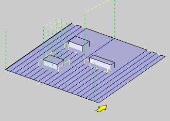

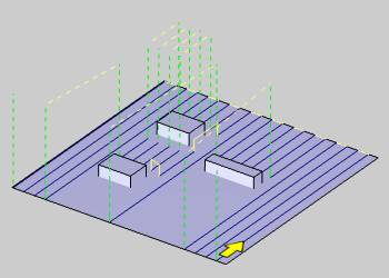

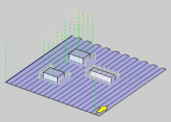

    • Trim after first collision - trims all toolpath beyond the first collision on that particular pass.
    • Trim before last collision - trims all toolpath prior to the last collision on that particular pass.
    • Trim between first and last collision - trims all toolpath occurring between the first and the last collision.
    • Trim before first collision - trims all toolpath occurring prior to the first collision.
    • Trim after last collision - trims all toolpath occurring prior to the first collision.
Clearances for tool parts - launches the Tool Clearances dialog box. Click here for more information on the Tool Clearances dialog box.

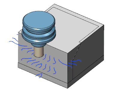

Check Holder with -
In Process Stock - The holder will not be checked against the in process stock.
In Process Stock - This enables the toolpath calculation to gouge check the tool and holder against the in process stock.
ClosedClick here to see an example.
Note: In Process Stock is the stock as it would appear at any point in the operation. As the operation is run, material is continuously being removed. As material is being removed, the stock to check against the tool and holder for gouges is continuously being updated. With this method, the Gouge Checks are run as the toolpath is being generated.
Machining Surface - The holder will not be checked against the in machining surface with this method.
Machining Surface - This enables the toolpath calculation to gouge check the tool and holder against the selected geometry.
Tip: This option is best utilized when the selected geometry is not completely inside of the stock material.
