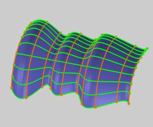

The Flowline toolpath uses the UV lines of the selected surface to determine the general toolpath direction. The following image shows the UV lines for the example part using green and orange. Notice the lines are perpendicular to each other.
UV Lines

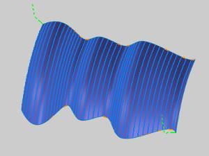

Along Toolpath
When you compute the toolpath using the default Along, you get the following result.

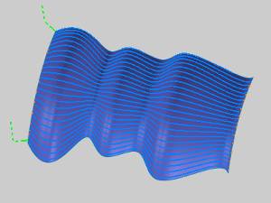

Around Toolpath
When you compute the toolpath after changing to Around, you get the following result.
