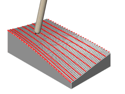

The Advanced options for surface quality dialog is available for all surface based toolpaths, and deals with the points that are created on a surface which are used to define the toolpath precision. For one cut along a flat surface with no tool tilting, two toolpath points are sufficient. Curved surfaces require many more points to account for constantly changing surfaces and tool tilting. Even though a tolerance is used, the amount of toolpath points needed varies greatly from one surface to the next. For surfaces with less toolpath points (flat or slightly curved) the Chaining Tolerance allows more control over the accuracy of the toolpath.

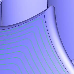

    Select the check box to create morphing toolpaths with a consistent stepover. This will increase the toolpath calculation time.
    Clear the check box to turn off adaptive cuts and use a normal stepover.
Adaptive cuts Adaptive cuts
Note: Notice the difference in the stepover at the bottom.

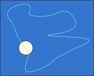

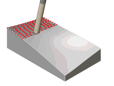

1) The toolpath forms a cusp: In the next image the yellow dots represent possible toolpath points along the toolpath.

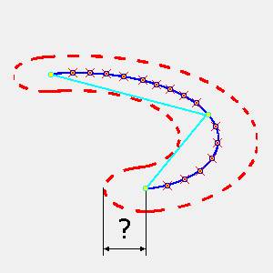

  • We can consider that the chaining tolerance is as a circle around the present toolpath points. The larger the tolerance-the more points are covered by the circle.
  • The chaining tolerance (the circle) is catching many toolpath points. Because of this, the algorithm uses the wrong points in the chain and the toolpath is generated cutting off some toolpath segments.
  • To assure the right chaining, the tolerance must be decreased.

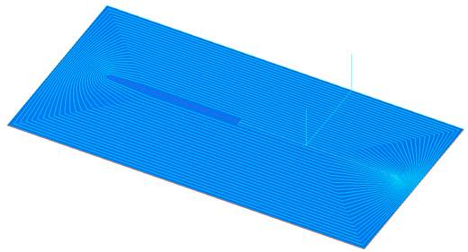

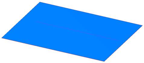

The next image illustrates a flat surface with the toolpath pattern Morph Between 2 Curves. The two curves are the outer boundary of the face and a thin contour inside the face.
  • The thin contour inside is also a closed contour. This image shows one contour edge.

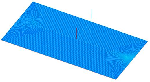

  • With the chaining tolerance set to 2mm the resulting toolpath shows a gap close in the toolpath. The chaining of the toolpath points went wrong.
  • The reason for this is the large chaining tolerance. Notice in the previous image that at the inner curve the toolpath on both sides are very close together. What happened here is that the toolpath was connected accidentally to a wrong toolpath point. A smaller chaining tolerance helps.
