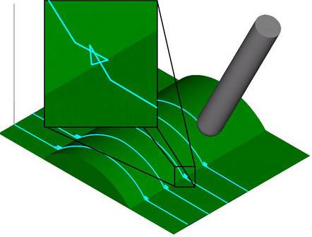

  • This is the toolpath without Round Corners activated.

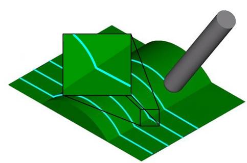

  • This is the toolpath with Round Corners activated.
