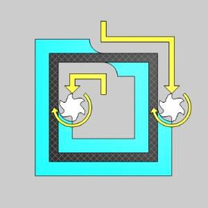

Climb cutting vs Conventional cutting
Understanding the difference between these cutting methods is an important first step in their implementation.
  • Climb cutting
    This method is sometimes referred to as "Down cutting". The reason for this is evident in the following image.
  • White - Tool
  • Black - Final part
  • Yellow - Tool direction/spin
  • Blue - Stock material
  • Red - Engagement area of next tooth
Notice how the next tooth will move down into the material, and how the chip will end much smaller than it starts.

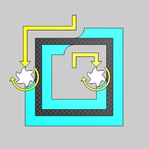

  • Conventional cutting
    This method is sometimes referred to as "Up cutting". The reason for this is evident in the following image.
  • White - Tool
Notice how the next tooth will push up into the material, and how the chip will end much larger than it starts.

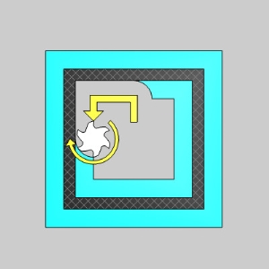

Chain direction: Clockwise or Counter Clockwise
In this section, we will look at direction of the tool and the compensation needed to achieve climb and conventional cuts.
Stock:
Climb cuts:
To achieve a Climb cut on an inside geometry, a counter clockwise direction used with left compensation is necessary.
To achieve a Climb cut on an outside geometry, a clockwise direction used with left compensation is necessary.
In the image below you can see how inner and outer climb cuts require opposing directions.
Conventional cuts:
To achieve a Conventional cut on an inside geometry, a clockwise direction used with right compensation is necessary.
To achieve a Conventional cut on an outside geometry, a counter clockwise direction used with right compensation is necessary.
In the image below you can see how inner and outer conventional cuts require opposing directions.
