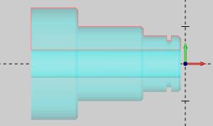

  2. In the Stock Definition page, Cylindrical stock is selected by default in the Stock Type section.
    In the Size section, enter:
    Stock Diameter - 3.50
    Internal Diameter - 0.75
    Length - 6.00
    Stock Origin (Z) - 0.00
Note: In the example shown, the stock face is at Z0 and does not need to be modified. The Stock Origin (Z) will allow you to alter the location of the stock in relation to the machine setup.

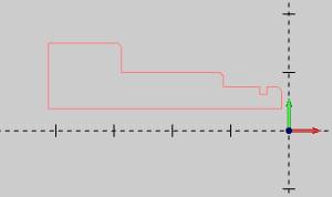

In the event that a custom stock is needed, you can draw 2D geometry that is revolved around the X-axis of the WCS to create the stock. The Lathe machining Z-axis is automatically aligned to the X-axis of the WCS used to draw the geometry.
  1. To create custom stock from the part shown in method one, the geometry is drawn as shown next.

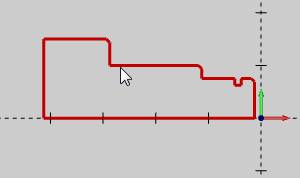

  4. Press and hold Shift, and click the custom profile to select the entire chain.

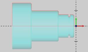

  5. To confirm the selection, click Calculate Stock.

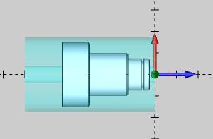

The custom stock geometry is created. The software automatically sets the stock parameters based on the revolved geometry.

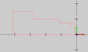

Tip: In order to define the same custom stock with an internal diameter, draw the geometry as shown next, and apply the same process as explained previously.
