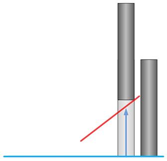

Examples

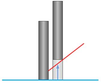

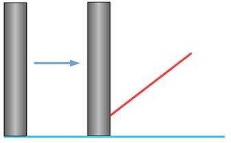

Example 1
- This image shows a situation with
a tool machining a flat surface (blue) and having a collision with
a check face (red).
- At the area of collision, the tool
retracts along its tool axis.
- After the collision, the tool plunges
back down to the drive surface.

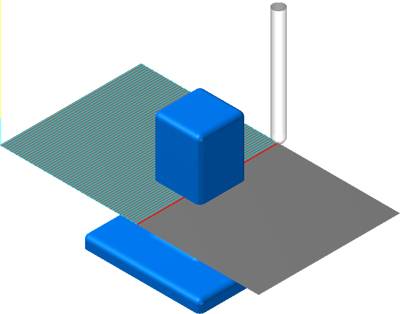

Example 2

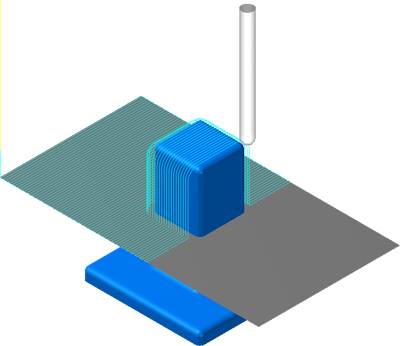

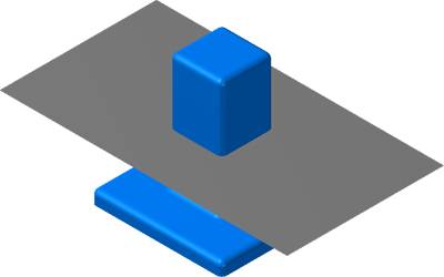

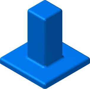

- In the next example the purpose is
to create parallel cuts on all faces of the following part.
- Next a flat surface is created for
use as a drive surface.
- The toolpath is generated on the drive
surface.
The previous image shows that the
toolpath is colliding with the part. The gouge check strategy Retract
Tool Along Tool Axis is selected as shown next.

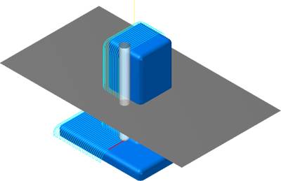

- The toolpath doesn't gouge the blue
faces, but it doesn't machine the floor faces either. The next step
is to select Drop Tool Down Wherever Needed. The result is shown in
the next image.
- The tool plunges through the grey
drive surface and reaches the lower faces of the part. Now, actually
all motions on the flat surface are not necessary. With Remove Areas
Where Tool Drop Fails selected, all unnecessary motion are deleted.
