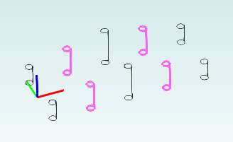

Edit the Feature, Break and Regroup Holes
For reference, the following image shows the current hole groups using one color for each group. Remember that each hole diameter is a single feature and we are working with two features (both are shown in the image).
After breaking and regrouping holes in the following steps, the hole groups are as follows (one color for each hole group). This final grouping allows us to optimize the toolpath for both features.

Under Hole Groups, click anywhere in the row of the Low group to select the group and display the preview.
With the Low group selected, click Break Hole Group.
The group is separated into four single-hole groups (Low.1 through Low.4). -
Click anywhere in the row of group Low.1 to select it.
Press and hold the Ctrl key, and click Low.2 to add it to the current selection.
We can see that Low.2 is on the opposite side of the part so we don't want to regroup these holes.
Tip: You multi-select items in the Hole Groups list using the Shift and/or Ctrl keys. Hold Ctrl and click a group to add it to or remove it from the current selection. Hold Shift and click a group to select all groups between the first and second selections.
Hold the Ctrl key and select group Low.2 to remove it from the selection. (Click the row of Low.2 in the Number column.)
Press Ctrl and click Low.4 to add it to the selection.
We can see that Low.1 and Low.4 are on the same side of the part, so these are the two holes we want to regroup.
With both Low.1 and Low.4 selected, click Regroup Holes.
Click the new group Low.1 to confirm the new grouping.
There are only two holes left on the lower level, so click Low.2, then hold Ctrl and click Low.3.
Click Regroup Holes to create a new Low.2 group.
