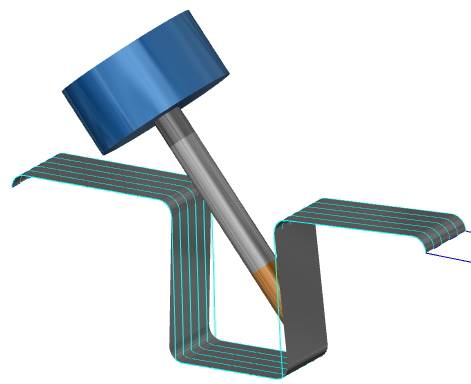

  • In this example the tool stays normal to the drive surface. The shape of the drive face forces the tool to gouge.

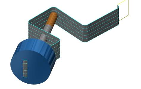

  • By using Use Lead/Lag Angle the tool tilts away from the collision.
Important: Extra attention is required when using flat tools. When using an end mill, tilting forward or backward changes the contact point of the tool which can result in other collisions.
