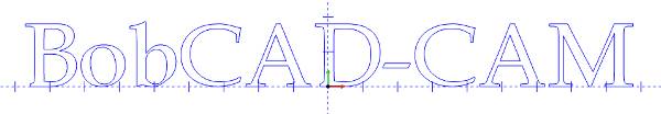

  3. In the Data Entry Manager:
    1. The Windows Font button should be selected by default.
    2. In the Font box, click the down arrow, scroll down, and select Book Antiqua.
    3. Click anywhere In the Text box (the blank white box under the font), and type BobCAD-CAM.
    4. Change the Height value to 2.000.
    5. Click OK.
    6. Click Cancel.
  4. The text is created at X0 Y0 Z0 in the graphics area. (Click anywhere in the Workspace and press F to activate the Fit All command, which is also found in the document toolbar.)

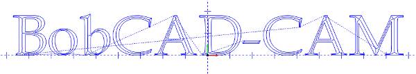

  13. Click Next>> to go to the Machining Strategy. Notice under Current Operations, a single V-Carve Finishing operation is already selected.
  14. In the tree on the left, click V-Tool to go to the Tool page. For this example, we use the default 0.5000 inch diameter V-tool. Note the selected tool size does change the toolpath calculation for V-carve finishing operations.
  15. Click Next>> to go to the Parameters. Notice under Depth Options, the V-Tool Depth of Cut parameter. This value is used to limit the depth when the width of the geometry profile is greater than the width of the tool. Again, we use the default settings for this example. For more information on specific parameters view the V-Carve Operation and the Mill Wizard topics.
  16. At the bottom of the wizard, click Compute.

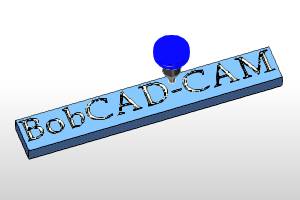

  1. To view the toolpath simulation, right-click Milling Job and click Simulation. For more information on using simulation, view Getting Started with Simulation.
