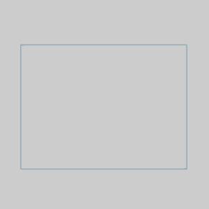

2) Create the Rectangle
  1. In the Shapes group, of the Create 2D ribbon, click Rectangle.
  2. In the Data Entry Manager, change the Length (X) value to 4.000, the Width (Y) value to 3.000.
  3. In the Option group of the Base Point section, click to set the Base Point at the bottom left of the rectangle.
  4. Click OK to create the rectangle as shown in the CAD preview.

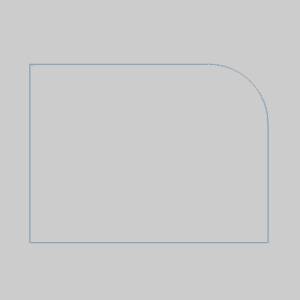

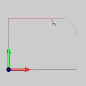

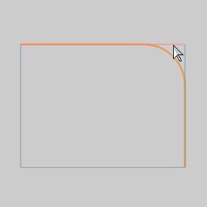

3) Create the Fillet
  1. In the Corners group, of the Create 2D ribbon, click   Fillet.
  2. Click anywhere in the graphics area, and zoom out so the entire rectangle is visible.
  3. In the Data Entry Manager, update the Picking Method to Single Corner Click.
  4. Change the Radius value to 1.000, and confirm that the Trim check box is selected.
  5. Hover over an entity in the top-right corner of the rectangle.
    The Preview appears.
    Click the entity to create the fillet.
    The fillet is created.
  6. Click Cancel to close the Data Entry Manager.

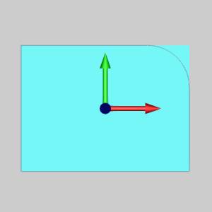

5) Create the Stock
  1. With Rectangular selected, the software automatically creates a bounding stock for the rectangle in the graphics area.
  2. In the Dimension / Offset group, enter:
  X Y Z
Dim 4.000 3.000 1.000
Offset + 0.250 0.250 0.000
Offset - 0.250 0.250 0.000
  1. Click to go to the Machine Setup.
    For this example, we use the default settings for the machine setup location.
6) Set the Work Offset
  1. Click the Work Offset button.
    The Work Offset dialog launches.
  2. Next to Z, change the value to 1.000 and click OK.
  3. Click OK to finish the Machine Setup.
7) Blank the Stock
  1. In the CAM Tree, right-click Stock, and select Blank/Unblank.
    The Stock disappears.

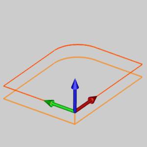

8) Create the V-Carve Feature
  1. In the CAM Tree, right-click Machine Setup, and click Mill V-Carve.

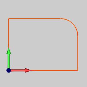

9) Select Geometry for the Feature
  1. In the Mill V-Carve Wizard, click the Select Geometry button.
    The Mill V-Carve Wizard disappears, allowing you to select geometry from the graphics area.
  2. Press and hold Shift and click anywhere along the rectangle to chain select it.

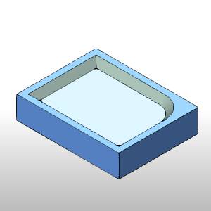

  3. Press Ctrl+7 to enter into an isometric view.

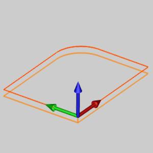

10) Set the Depth of the Feature
Notice the feature preview displays the current depth.
  1. In the Total Depth group, change the Depth to 0.250, and press Tab.
    The preview updates.
  2. Click (OK) to confirm the selection.
    The Mill V-Carve Wizard reappears.

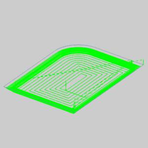

15) Set the Finishing Parameters
  1. Under Depth Options, change the V-Tool Depth of Cut value to 0.0625.
  2. Change the V-Tool Roughing Stepover value to 0.0300.
Note: Notice the V-Tool Cleanup Parameters. Because we are using a Tapered Pocketing operation, we can set the stepover to perform a cleanup path in the corners of the pocket using the V-tool.
  1. Change the V-Tool Cleanup Stepover value to 0.005.
  2. At the bottom of the wizard, click Compute.
  3. To view the toolpath simulation, right-click Milling Job and click Simulation. For more information on using simulation, view Getting Started with Simulation.
