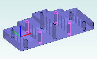

For this example, you can select the cylindrical surface of each hole directly from the model, but to make selection easier, a separate CAD layer contains a copy of only these surfaces. (Note that the Point and Arc Usage options do not apply when selecting cylindrical surfaces.)
Tip: We are selecting cylindrical surfaces because this allows the software to automatically set our diameter, top of feature, and feature depth. To learn about selecting other geometry types, view the Point and Arc Usage Example.
  1. In the Quick Selection group, of the Home ribbon, click Pick By Layer.
  2. In the Select Layer dialog box, click Holes.
    Click OK.
  3. Click OK in the Selection Manager.
    Geometry selection is finished. Notice the hole list displays each diameter hole and its parameters. The software automatically creates a separate Mill Hole feature for each hole diameter. The Depth value for both of our hole sizes displays as Multiple. This is due to the multiple depths that are achieved in a single feature using hole groups. The hole depths can be modified in the wizard later, as needed.

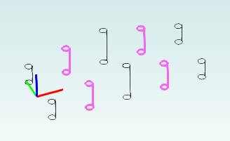

After viewing the toolpath, we see one issue. The rapid plane, applied within hole groups, is going through the steps of the model because the holes on opposite sides of the part are in the same group. The rapid movement between hole groups is determined by the group retracts as seen in the link moves that retract up above the part. Next we modify our hole groups to alleviate the issue.
Edit the Feature, Break and Regroup Holes
For reference, the following image shows the current hole groups using one color for each group. Remember that each hole diameter is a single feature and we are working with two features (both are shown in the image).
After breaking and regrouping holes in the following steps, the hole groups are as follows (one color for each hole group). This final grouping allows us to optimize the toolpath for both features.

  1. Under Hole Groups, click anywhere in the row of the Low group to select the group and display the preview.
  2. With the Low group selected, click Break Hole Group.
    The group is separated into four single-hole groups (Low.1 through Low.4).
  3. Click anywhere in the row of group Low.1 to select it.
Press and hold the Ctrl key, and click Low.2 to add it to the current selection.
We can see that Low.2 is on the opposite side of the part so we don't want to regroup these holes.
Tip: You multi-select items in the Hole Groups list using the Shift and/or Ctrl keys. Hold Ctrl and click a group to add it to or remove it from the current selection. Hold Shift and click a group to select all groups between the first and second selections.
Hold the Ctrl key and select group Low.2 to remove it from the selection. (Click the row of Low.2 in the Number column.)
Press Ctrl and click Low.4 to add it to the selection.
We can see that Low.1 and Low.4 are on the same side of the part, so these are the two holes we want to regroup.
  1. With both Low.1 and Low.4 selected, click Regroup Holes.
Click the new group Low.1 to confirm the new grouping.
  1. There are only two holes left on the lower level, so click Low.2, then hold Ctrl and click Low.3.
Click Regroup Holes to create a new Low.2 group.
  1. Repeat this process of breaking and regrouping holes for the middle level (group Mid) so that each group only contains the holes that are on the same side of the part.
There is no need to break the High hole group.
Breaking group Mid results in the following groups.
Mid.1
Mid.2
Mid.3
Mid.4
Groups Mid.1 and Mid.4 are regrouped to create a new group, Mid.1.
Groups Mid.2 and Mid.3 are regrouped to create a new group, Mid.2.
To update the changes for this feature, click Compute.
