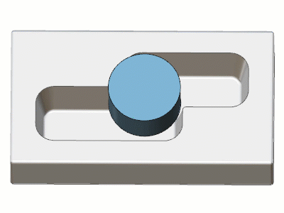

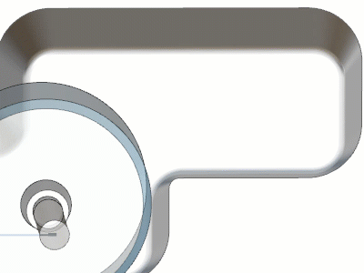

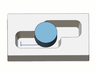

- Remove Corner Pegs
- Clear the check box to turn off Remove Corner Pegs.
- Select the check box to add extra tool movement in corners, removing the rest material; for use when a stepover greater than 50 percent results in small pegs of material remaining in the corners. With this check box selected, you will be able choose between the following three options.
- Line-Arc-Line - removes the corner pegs with an arc between two lines as seen in the animation below.
- Arc - removes the corner pegs with a single looping arc motion as seen in the animation below.
- Line - removes the corner pegs by moving away from, and back to the toolpath with a straight line as seen in the image below.
