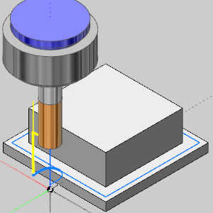

The patterns page allows you to choose a pattern for the cuts, and also gives you control of the compensation used.
Patterns
Standard- creates a toolpath for cutting the perimeter of one or more contours at a constant depth. (This is the only option available for Finish operations.)
- Apply Tabs - when tabs have been created on the Tabs page of the Mill 2 Axis Wizard, the Apply Tabs check box will appear when the Standard Pattern is selected.
- Tabs will be applied to this operation.
- Tabs will not be applied to this operation.
Contour Ramping - creates an uninterrupted continuous step down, or a spiral type toolpath. Set the cut Angle or Depth per Pass in the Parameters section of the wizard.
Side Roughing- is used when excessive stock remains on the part, and you want to have the tool step into the feature in specified increments. This option allows you to create multiple passes by offsetting the target profile instead of creating a single pass from the profile.
- Stock Remaining-
sets the total amount of material that exists for the side roughing
operation.
- Number of Passes - sets the number of passes applied to the operation. The Stock Remaining value is divided by this value to determine the stepover distance of each pass.
