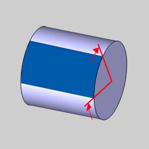

Zig - sets the cutting method to one-way. All cutting feed moves share the same direction.
Zig Zag - sets the cutting pattern to alternate directions. Each toolpath segment changes cutting direction along the part.

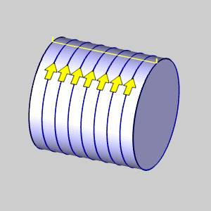

Spiral - (used with Around style only) creates a spiral or ramping cutting pattern along the surface.

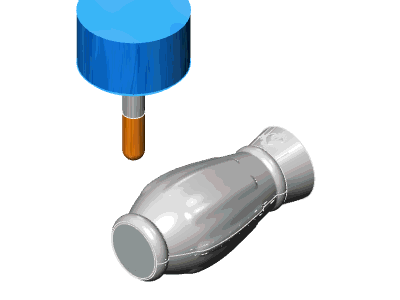

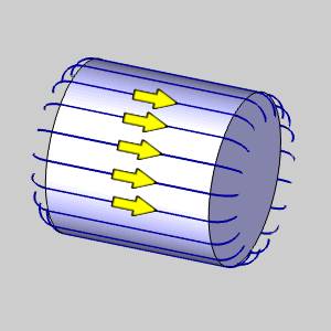

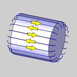

Along - creates a toolpath that is parallel to the rotary axis of the part.

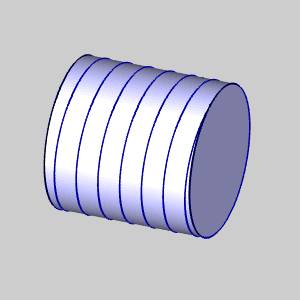

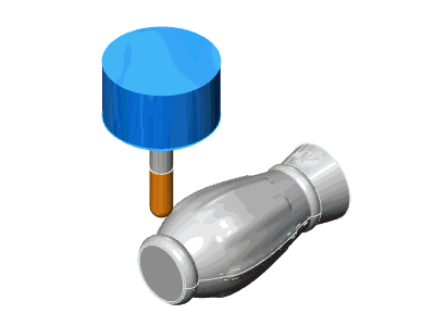

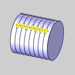

Around - creates a toolpath that is normal to or cuts across the rotary axis of the part.
Along |
Around |

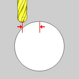

SideShift - defines a distance that the tool is shifted away from the center of the rotary axis. When a side shift is applied, the tool does not point directly to the rotary axis. This can be used to minimize cutting with the center of the tool (or to cut with the front of the tool).

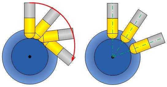

Point Tool to Rotary Axis
Select the check box to force the tool axis to point at the defined rotary
axis of the part.
