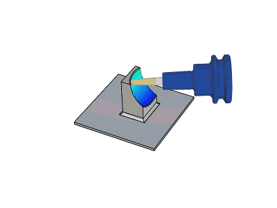

  • Maintain Tilt
Select the check box to keep the cutting side of the tool constant. This will help to prevent cases when the surface normals of fillets change from 90° to 0°.

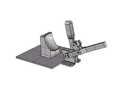

ClosedClick here to see an example of Maintain Tilt assisting the tilt direction.
Clear the check box to use the original tool orientation.
ClosedClick here to see an example of an issue Maintain Tilt could help correct.
Maintain tilt is deactivated. Notice, as the shallow end is machined the surface normal cause a tilt into the blade and sudden changes in tilt direction.

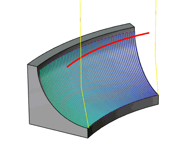

Tilted Through Curve
Tilted Through Curve - uses a geometry curve that is located above the drive surface. The tool axis orientation is aligned through the curve to the surface. The available parameters change slightly depending on which Curve Tilt Type is selected, so all of the parameters are explained together.
  • Tilt Curve - enables selection mode for you to select the tilt curve geometry. The tool orientation always points towards the tilt curve based on the selected Curve Tilt Type.
  • Tilt Angle - is an additional angle that is added to the tilting that is defined through the curve.
  • Advanced - opens the Advanced Options dialog box with the following option.
    • Side Tilt Fanning Distance - smooths out sudden changes in tool orientation when cutting across multiple surfaces, or from one surface to another. This distance defines how far from the intersection of the surfaces the tool begins to change orientation.
When using Tilted Through Curve with Angle from Spindle Main Direction and a Tilt Angle greater than zero, the following options become available (in addition to the Side Tilt Fanning Distance).
    • Curve Tilt Fanning Distance - smooths changes in tool orientation when cutting across the selected tilt curve. This distance defines how far from the curve the tool begins to change orientation.
    • Snap to Curve - causes the tool to snap to the tilt curve when crossing it. This can be used to create a smoother tool orientation changes when the tool crosses the tilt curve.
ClosedView Curve Snapping and Fanning Off Example
ClosedView Fanning Applied
ClosedView Snap to Curve Applied

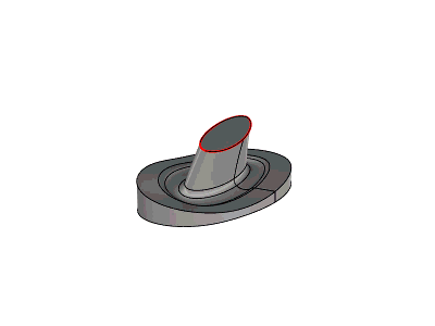

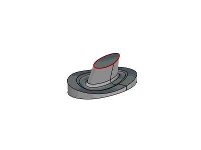

Tilted Relative to Impeller Machining Layer
Tilted Relative to Impeller Machining Layer - is designed for use with impeller machining.
  • Tilt Lines - enables selection mode for you to select the tilt line geometry which is used to align the tool orientation. For impellers with a splitter, you select the leading, trailing, and splitter edges (3 selections). If there is no splitter, you select the leading and trailing edges of the main blades only (2 selections). This is shown in the Tilted Relative to Impeller Machining Layer topic.
  • Impeller Rotation Axis - defines the rotational center of the impeller. Select X-axis, Y-axis, Z-axis, or Line. When Line is selected, click . You can type coordinate values, or click Pick to select geometry.
  • Global Lead Angle - defines the lead/lag angle in relation to the Impeller Rotation Axis. The initial tool axis orientation is normal to the surface, positive values tilt towards the rotation axis, and negative values tilt the tool away from the rotational axis.

  • Common Direction - The aim is to find a single tool axis orientation on the full toolpath or a single contour. The option is available for all tilting strategies and alternates the tilting after the initial tilting. This means an initial tilting strategy will have to be defined to begin with, e.g. Tilted Through Point. With the Common Direction, the tool axis is set to a normalized, single direction for all toolpath points.
Select the check box to have the system find a single tool axis orientation on the full toolpath or a single contour.
ClosedClick here to see Common Direction in use.

Clear the check box and Common Direction will not adjust the tilting strategy.
ClosedClick here to see default tilting strategy without Common Direction.
