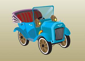

In this example, a color image of a car is used to create vector geometry.The image used is shown next.

  4. Select OldCar.bmp, and click Open.
    The Load Image dialog opens and the image is loaded and displayed in the graphics area.
    Notice the Image-Old Car item is added to the BobART tree under Images.tree that contains the image (Sketch Picture).

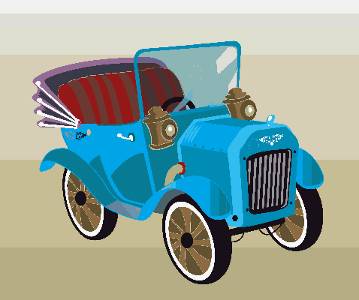

In this section we begin using the multi-color strategy to vectorizethe image and begin exploring the various workflow options for creatingand saving geometry.
  1. In the BobARTtree, right-click Image-Old Car, and click Vectorize.
    The Vector... dialog is displayed.

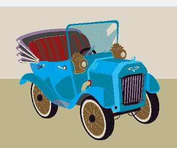

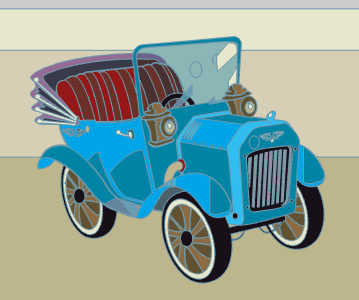

  2. In the Method group of the Strategy section, click Multi-ColorStrategy.
    The image is shown divided into 64 specific colors.The multi-color strategy defaults the number of colors to 64, whichallows you to target very specific colors or color ranges in the imagein order to be more precise with the vectorization results.Experimentationwith the number of colors is an important aspect of learning to vectorizeimages in an efficient manner.
  3. Next to #of Colors, click the down arrow and select 64.
  4. At the bottom of the Parameters group, under the color boxes, click CheckAll.
  5. Click Apply to vectorize the image in its current state.

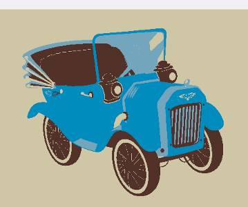

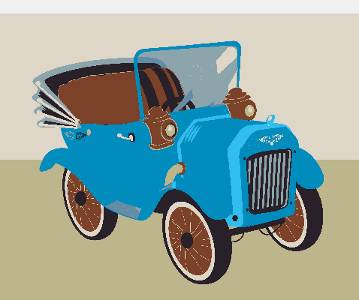

  6. Next to #of Colors, click the down arrow and select 32.Notice the change in the preview.For example, the gradient of theimage background is reduced from 6 unique colors to 5, and the yellowand orange colors are removed from the head lights and the exhaust.
    When you change the number of colors, the image is actually reducedto the selected number of colors, and the color boxes update underColors to be Vectorized.
  7. Continue reducing the #of Colors (for example to 16, 8, and 4), and observe the changein the preview.
  8. Change the #of Colors to 24 andclick Check All to automaticallyselect the check box of all colors.
  9. Click OKto vectorize the image.
    The image is processed using all 24 colors to createthe vectorized geometry.Notice the horizontal lines.This is a resultof the gradient in the background of the image.The current settings separatedthe gradient into three unique colors.

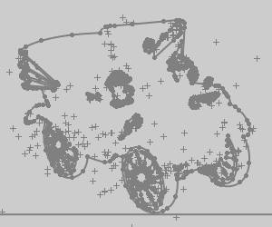

Remove Chains Less Than
  1. Next to Image-Old Car,click to expand the tree item.
    To edit the parameters, right-click Vectorization,and click Edit.
Note: You can also right-click Image-Old Car, and click Vectorize.
  1. In the Vectorize... dialog, set the # of Colors to 64.
  2. Click UncheckAll.
  3. Select the colors seen in the image below.
  4. Click the Blank Image button at the top-right to hide the image so we can better view the results.
  5. Click OK.
    Notice that the geometry from the first vectorizationis removed and replaced with new geometry.

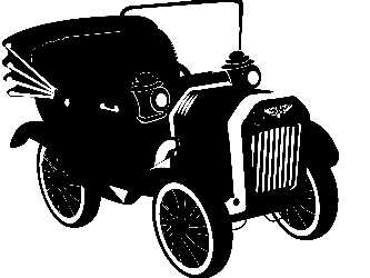

Part 6) Use the Black and White Strategy
The 2 Level Black and White Strategy
This section explains how the Vectorize... dialog is used tocreate and modify the vectorized geometry.We start by experimenting withthe 2 Level Black and White strategy, as it is a viable option for vectorizingcolor images or black and white images.The strategy simply determineshow the image is analyzed in order to create geometry.

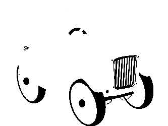

    The Vectorize dialog displays and the image appears in blank and white with only portions visible.
    This is because in the Strategy section, the Method is set to 2 Level(Black/White) Strategy by default.
  2. In the ThresholdValue field, update the value to 40.
    No noticeable change occurs.
  3. Update the value again, but this time, use 60.
    Notice the preview of the image updates each time that you change thevalue.
    You can also click and drag the Threshold Value slider, in small increments,and release (to accomplish the same task).
  4. Change the Threshold Valueto 140.
  5. Click OK to vectorize the imageand update the original sketch feature.
    Hide the image to view the geometry.
    The resulting geometry is placed on the active layerautomatically adds to the SolidWorks Feature Manager design tree.It is important to understand that when you edit the Vectorizationparameters in the Vectorize... dialog, the previous resultis replaced.This allows you to experiment with the vectorizationresult without creating excessive features or geometry.

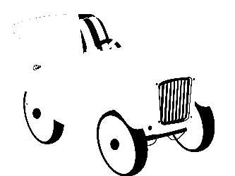

  6. To edit the vectorization we did, either:
    1. Right-click Image-Old Car, and click Vectorize... to enter the dialog again.
    2. Under Image-OldCar, right-click Vectorization,and click Edit.
      The Vectorization itemwas added to the BobART tree after the first vectorization.
  7. Change the ThresholdValue to 174 and clickOK to update the vectorizationresult.
For this part, you experiment with the Black and White strategy to getthe profile of the car.
  1. In the document toolbar, click to enable selection mode.
    Press and hold Shift, and clickto chain-select the profile of the car as shown next.

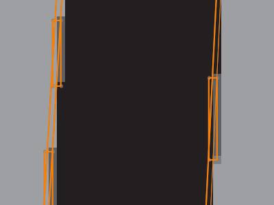

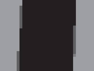

The Remove Chains Less Than parameter is very important when vectorizingimages, as it helps you to remove unnecessary geometry that may be createdfrom the gradients in an image.
  1. Show the image, and zoom-in closely to differentareas of the image and notice the geometry as compared to the selectedcolors (gradients).For example, the grill on the front of the caror the wheels are a great place to view how the geometry is createdbased on the colors.
    The following image shows the colors of the front grill zoomed in closelywith the geometry hidden from view.You can see that there are actuallythree colors that make the vertical black and gray stripes.
    Because we have vectorized all 24 colors, the software created geometryfor each color.The first point here is that you may not want to vectorizeadjacent colors, as it results in what appears as duplicate geometry,although it isn't.It may be better to vectorize only one of the colors.The second point is that the darker gray color results in very smallentities that are most likely not needed.The geometry from our vectorizationis shown next highlighted to make it easier to view.
    You can see the small rectangles are not needed, so now we use theRemove Chains Less Than parameters to remove them.
  2. Right-click Vectorization,and click Edit.
  3. Under VectorizeParameters, change the RemoveChains Less Than value to 75(pixels), and click OK.
    You can see that the small groups of entitiesare now removed from the result.You can experiment with the Remove ChainsLess Than value to make the vectorization result more efficient.Nextwe explore more ways to be efficient with vectorization.

The Remove Chains Less Than value was changed to100, to create the following result.
Be sure to reduce the Remove Chains Less Than value(if needed) when moving on to vectorize a new area of the image.

In this part, the seat is the target area from which you create geometry.
  1. Right-click Vectorization,and click Edit.
  2. Change the #of Colors to 20.
  3. Select the following colors.
  4. In the Remove Chains Less Thanbox, type 100.
  5. Click OK.
    The result appears as though some of the geometry is missing from theseat.To confirm if this is correct, show the image, and compare theimage and the geometry.You may want to hide and show the image afew times as you examine certain areas.You can see that the geometryfrom the seat is accurate (the steering wheel and the windshield causethe missing areas.)
    You could window select the (seat) geometry and copy it to a new layer,but you would get double entities that need to be cleaned up later.In the following steps, you edit the vectorization and get the seatgeometry in two steps.This again helps you to get clean geometrythat requires less editing later.
  6. Edit the vectorization, and click to clear thebottom-left check box.
  7. Click OK.
    You can see that now you have much cleaner results.
    Show and hide the image a few times to compare the image and the geometry.
    The result is grabbing mostly the brown areas of the seat.
  8. Use chain-selection to select the desiredgeometry, and copy it to the SeatBrowns layer.
  9. Use chain-selection to select the desired geometry, and copy it to the Seat Reds layer.
  10. Edit the parameters, and select the following colors.
    Click OK.
    This time mostly the red areas of the seat are vectorized.
    Show and hide the image to compare.
  11. Copy the desired geometry (remember to usethe chain-selection method), and paste it to the SeatReds layer.
    The brown areas of the seat are copied to the SeatBrowns layer.
    All of the geometry created so far is shown next.
  12. Continue this process until you have createdall of the desired geometry from the image.
