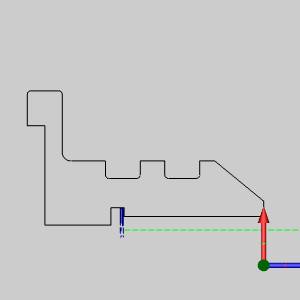

Part 3) Facing the Part
For most every Turning Job, you will need to face off the stock. By selecting a Lathe End Face feature, we will automatically create toolpath up to the machine zero without the need to select geometry. The only time geometry will need to be selected for the Lathe End Face feature is if the desired toolpath needs to end before, or, continue beyond the machine zero.
Add the Feature
  1. In the CAM Tree, right-click Machine Setup - 1 and select Lathe End Face.
    The Lathe End Face feature launches with the Geometry Selection page active. Since our target geometry is already at the machine zero, we do not need to select geometry.

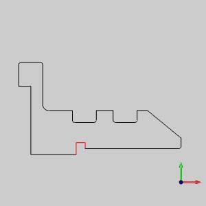

Part 4) Turning the Part
In this step we create a Lathe Turning feature, assign Rough and Basic Finish operations, and define the parameters of those operations.

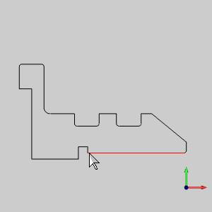

  1. In the CAM Tree, right-click Machine Setup - 1 and select Lathe Turning.
  2. Click Select Geometry.
    The Lathe Wizard hides and the Feature Geometry Picking dialog opens to allow geometry selection.
  3. In the graphics area:
    1. Left-click the end of the first entity to be turned.
    2. Going to the end of the last entity to be turned, hold Shift on your keyboard and left-click again to select all the entities between the two.
    3. Click OK to confirm the geometry selection and return to the Lathe Wizard.
Tip: To confirm geometry selections, you can also click the icon in the toolbars or simply press Spacebar.

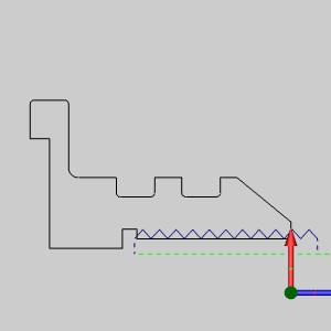

  6. Select Parameters.
Set Parameters and Compute
  1. Under Parameters, set Threads Per Unit to 5.0000.
  2. Select the check box for Override and set Thread Height to 0.1190.
Important: The Thread Height that is calculated in BobCAD-CAM is the theoretical sharp height. Depending on the thread being cut, you may need to adjust this value.
  1. Click Compute.

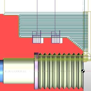

Part 9) Simulation
Open and Close Simulation
  1. In the Modules menu, click Simulation.
For help with simulation, view Getting Started with Simulation.
Tip: The Simulation contains a CutSim tab. Clicking on the Advanced Properties button will launch the Parameters dialog box allowing you to select the Enable check box in the Section plane group. This will put the stock in the section plane view seen in the image above. Leave the values as they are and click OK.
