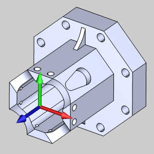

Part 1) Add the Feature
  1. Right-click MachineSetup and click Mill Multiaxis.
  2. In the MultiaxisWizard, click Deburring.
  3. Click Next>>to go to the Posting dialogbox.
  1. The WorkOffset # is automatically set to the value defined in the MachineSetup dialog box.
    This means that the Multiaxis Posting parameters for the feature usethe same parameters as the machine that is selected in Current Settings.
    You can clear the Use Machine Settingscheck box to define the Multiaxis Posting parameters of the featureseparately from the current machine settings.
    For this example, no changes are needed (more information is providedlater).
    The Tool Crib dialog appears.

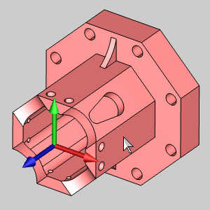

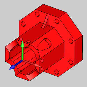

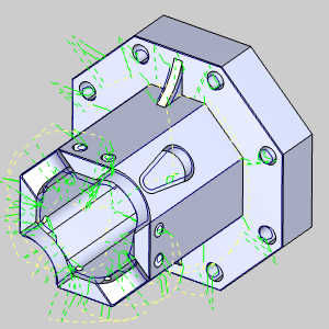

Part 5) Surface paths
  3. Select the model.

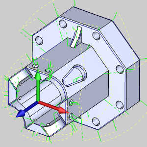

Part 6) Tool axis control
  3. Click Compute.

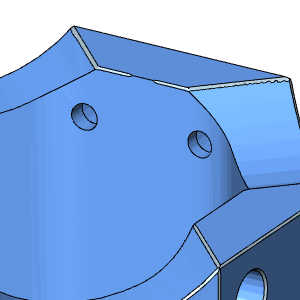

Part 7) Editing the feature

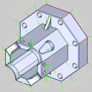

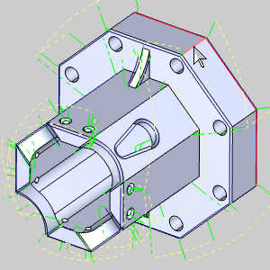

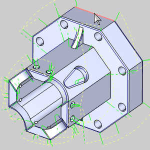

  5. Select the edge along the outer diameter of the part as seen in the image below.
  6. Repeat this for the remaining edges.
  7. Click OK.
  8. Click Compute.

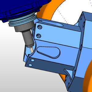

Part 8) Simulation
  3. To close simulation, in the menuSimulation group of the Milling Ribbon, click Exit Simulation.

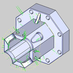

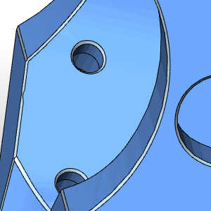

Part 9) Edit the feature
  5. Click Compute.
Part 10) Simulation
