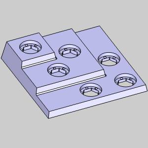

In this example part, we have used a Group to better manage our toolpaths.Adding a toolpath pattern to each of the three toolpaths we intend toduplicate would be a little too time consuming.Adding a toolpath patternto the entire machine setup, would duplicate toolpaths we have no intentionof patterning.The creation of a group, gives us control of all the toolpathscontained in the group at once.
  1. In the
  2. Right-click the Groupin the CAM Tree.
  3. Select Blank/UnblankToolpath.
    The toolpath for the three features we intend to pattern is no longervisible in the graphics area.

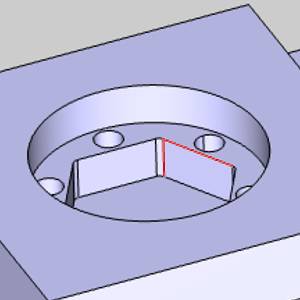

Part 3) Set the Start for the Toolpath Pattern
With the Toolpath Pattern dialog launched, we are now able to set theSpecified Points.If the distances between the original and its copiesare known, the Start can be left at zero and the differences can be entered.In this case we will use the Pick options to set the Start and usethe pointhighlighted in the image below.
Important: Pick optionsreference values in relation to the Machine Setup
  1. Click the Pickbutton in the Start groupto set the start position.

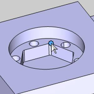

    The Toolpath Pattern Dialog hides and selection mode is enabled.
  2. Click the seenin the image and click OK.
    The Toolpath Pattern dialog returns.

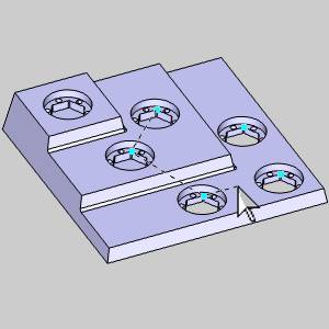

The Start and Positions determine the distances of our toolpath duplicatesfrom the originals.Since we have used the Pick option to select our Start,we will use the Pick Positions option to select our Positions.
  1. Click PickPositions.
  2. Take care to select the matching foreach of the remaining pockets in the order they are to be machined.

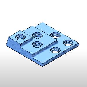

Part 6) Simulate the Program
  1. To view the part being cut, right-click Milling Job,and click Simulation.
To learn more about using Simulation, viewGettingStarted with Simulation.
The resulting stock model is shown next.
