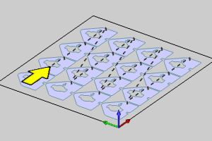

Cutting Sequence
Sets the starting position and cutting direction of the nested results. Select from the lists to determine the corner to start from, and then select either the up and down direction or left to right direction option.
Start Corner - allows you to decide where the cuts should begin on the nested sheet.
Upper Left |
Upper Right |
Lower Left |
Lower Right |

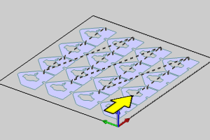

Cutting Direction - is the direction the sheet will be cut in. This can be thought of as the direction the wave of completed parts is moving in.
Horizontal (X) - sets line of completed parts to move horizontally.
Vertical (Y) - sets line of completed parts to move vertically.

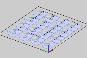

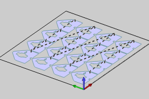

Cut Pattern

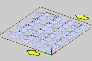

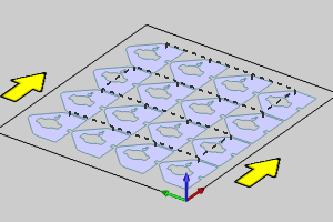

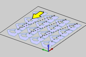

Parallel - the rows or columns are cut in opposite directions.

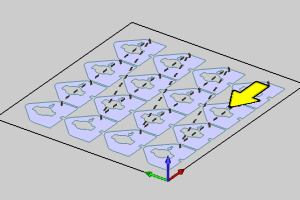

Zigzag - the rows or columns are cut in one direction.

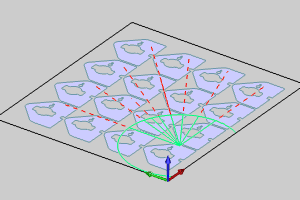

Max Part Distance - allows you to set a maximum distance to jump between the lead out of the current part, to the lead in of the next. In most cases, this is used to make sure that the cuts are kept as close together as possible.

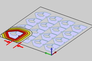

Thermal Distance - allows you to set a minimum distance to jump between the offset value of one toolpath to the offset of another. In most cases, this is used to make sure that the distance between one completed part and the next are far enough away that the heat from the cuts does not build up enough to cause warping. For more information on Thermal Distance, click here.

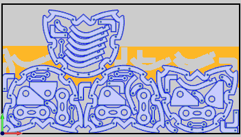

The Parameters section contains the following options to determine how the system calculates the nesting result.

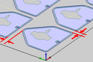

Bridge Distance - is the distance added between the toolpath for each part in the nested result.
Resolution - is the tolerance setting for the nest.

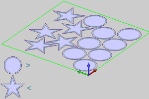

Sequencing - For parts with no priority assigned, this is a way to set which parts will be nested first.
By Area - parts whose toolpath creates a greater surface area will be nested first.
By Perimeter - parts whose toolpath creates a larger perimeter will be nested first.

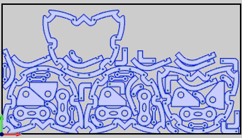

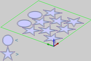

Part in Part
Allow Part in Part
By default, this check box is cleared. When cleared parts will not be
nested inside the inner profiles of other parts, even when sizes permit.
When selected, parts will be nested inside of other parts when possible.
Preferential Hole Filling
When cleared, no priority will be given to filling inner profiles.
When selected, the space inside the inner profiles of parts will be given
priority in the nested results.
