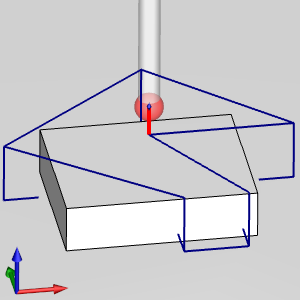

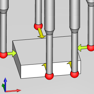

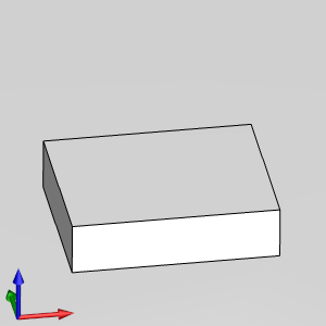

This cycle measures four sides of rectangular extrusion, whose walls are parallel with X and Y, in order to determine the length and width. This cycle can utilize the following geometry inputs:
  • Rectangular wireframe with sides parallel to the X and Y Axes.
  • Rectangular planar surface with edges parallel to the X and Y Axes.
  • Four planar surfaces whose normals are aligned along the X and Y Axes.

  • Distance Between 2 Points - This cycle uses a single contact point on three sides of the rectangle, and two contact points on the other. This value specifies the distance between those 2 contact points.

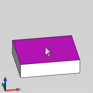

  1. Click the Parameters tab.
  2. Select the edge of the surface whose normal is parallel with the Y Axis.
    Since our current geometry works for a Z Single Surface cycle, that is the cycle that is currently selected for us.

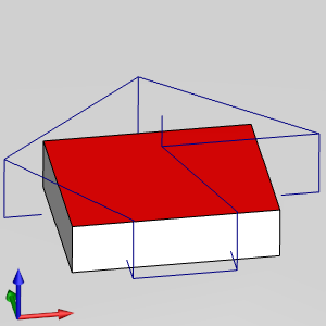

Part 5) Updating the cycle

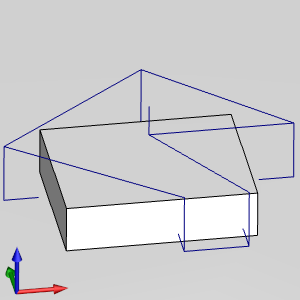

In this case, the geometry we have chosen could be interpreted as a Z Single Surface cycle. Once we update the cycle, our toolpath will be updated.

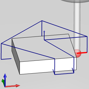

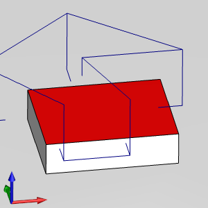

  1. At the top of the Cycles section click the drop down list and select 5-point Rectangle External from the list.
    The toolpath is updated.

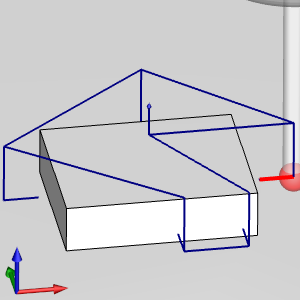

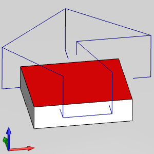

  1. In the Initial Position group, update the X value by adding -0.25 to the end, and pressing Tab.
    The value and the toolpath update to put the initial position of the probe a quarter inch further back in X.
  2. In the Initial Position group, update the X value by adding +0.25 to the end, and pressing Tab.
  3. In the Initial Position group, update the Z value by adding -0.375 to the end, and pressing Tab.
    The value and the toolpath update to put the moves between contact points three-eighths of an inch closer to the top of the part.
The Parameters section for this cycle consists of the Z Measurement Height, the Length and Width values, and the Update Work Offset value. In this case we will adjust the height at which the probe will make contact. The Length and Width values should not need to be adjusted since they are calculated automatically from the geometry and list the size of the rectangle to be measured.
Note: The value of the Z Measurement Height is an incremental height from the Machine Setup.
  1. Update the Z Measurement Height value by adding -0.25 to the end, and pressing Tab.

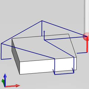

The Options section for this cycle consist of a total of three options: Two Measurements Face, First X Position, and Distance Between 2 Points. The Two Measurements Face option allows you to determine which side of the rectangle will use two contact points. The First X Position allows you to determine the point along the X Axis which a contact point will be used. The Distance Between 2 Points option allows you to set the space between the two contact point which occur on the same face. For this example will leave the two measurements on the bottom face, but we will explore the other two options.

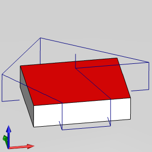

  1. In the Options section, select the check box for First X Position.
    The toolpath updates. Notice the contact point on the top face is now at the same position along the X Axis as the first point on the bottom face.
  2. In the Options section, update the First X Position value by adding +0.50 to the end, and pressing Tab.
    The toolpath updates. Notice we have updated the contact points on the top face, as well as the contact points on the bottom face.

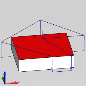

    Now we have an issue with the last contact point along the X Axis. We will need to adjust the distance between those two points to force the last point to come in contact with the surface.
  3. In the Options section, select the check box for Distance Between 2 Points.
    We can now update that value.
  4. In the Options section, update the Distance Between 2 Points value by adding -0.25 to the end, and pressing Tab.
    The toolpath updates. Notice the last contact point along bottom face is now in contact with the surface.

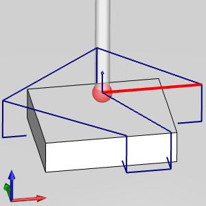

  1. Click the Options tab.
  2. Click Next two times to view the probe movements.
    Notice we seem to be clear of the surface edge, but to make sure, click Next twice more.
